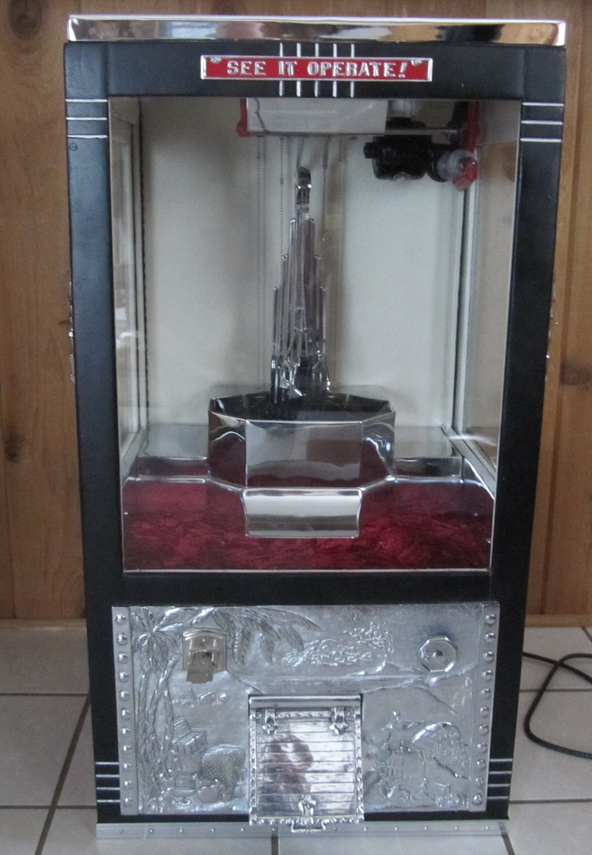

Postby gamblingman » Sat Feb 08, 2014 2:13 pm
I have had 2 Buckley Digger projects underway for several months now. Today I finished the Treasure Island version (with the exception of background artwork I have yet to add). The Jewel Box version will be coming along in a few weeks.

Postby clubconsoles » Sat Feb 08, 2014 6:00 pm
That's Beautiful, Gamblingman!
I am slowly getting there with my Buckley too!

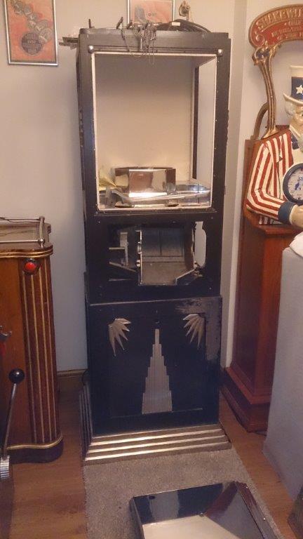

Postby clubconsoles » Sun Feb 09, 2014 2:29 am
Hi Gamblingman
I know exactly what you mean!
I have done a straightforward restoration on an Electric Travelling crane, an easy restoration on a Streamline Merchantman, but these Buckley Cranes are challenging, to say the least!
I have had to repair one of the chain spools with liquid metal as a piece of the aging pot metal broke off while polishing!
I had to have the locator piece that looks like a "tuning fork" entirely remade from stainless
The mechanism that stops you turning the locator once the crane is in play was also missing in its entirety so I had that made in stainless from pictures, as well!
Plating bill was equivalent of $1500+ (I went for nickel as Chrome was even more expensive)
There is something about the ebony case with the Stark Chrome trim and the general bold Art Deco design of these cranes that looks truly magnificent to me and I do enjoy a challenge, hence my love affair with these cranes!
I have read somewhere that the Buckley Chicago Digger I have is "art deco at its most formidable" and it is true that there is not a single curve in the diggers design.
My Digger is pretty good, case wise and came from a chap called Todd Weiss in Caifornia.
I had it shipped to the UK in pieces as it had already been stripped for restration.
Most of the key pieces were there although a corner piece of the glass frame was missing , so had to have that made as well!
I had more than one made so if you ever do a Chicago Deluxe with these missing, I have a spare set!
These pieces proved impossible too source as there don't seem to be many parts for these diggers "out in the wild" anymore.
all the best
Nigel

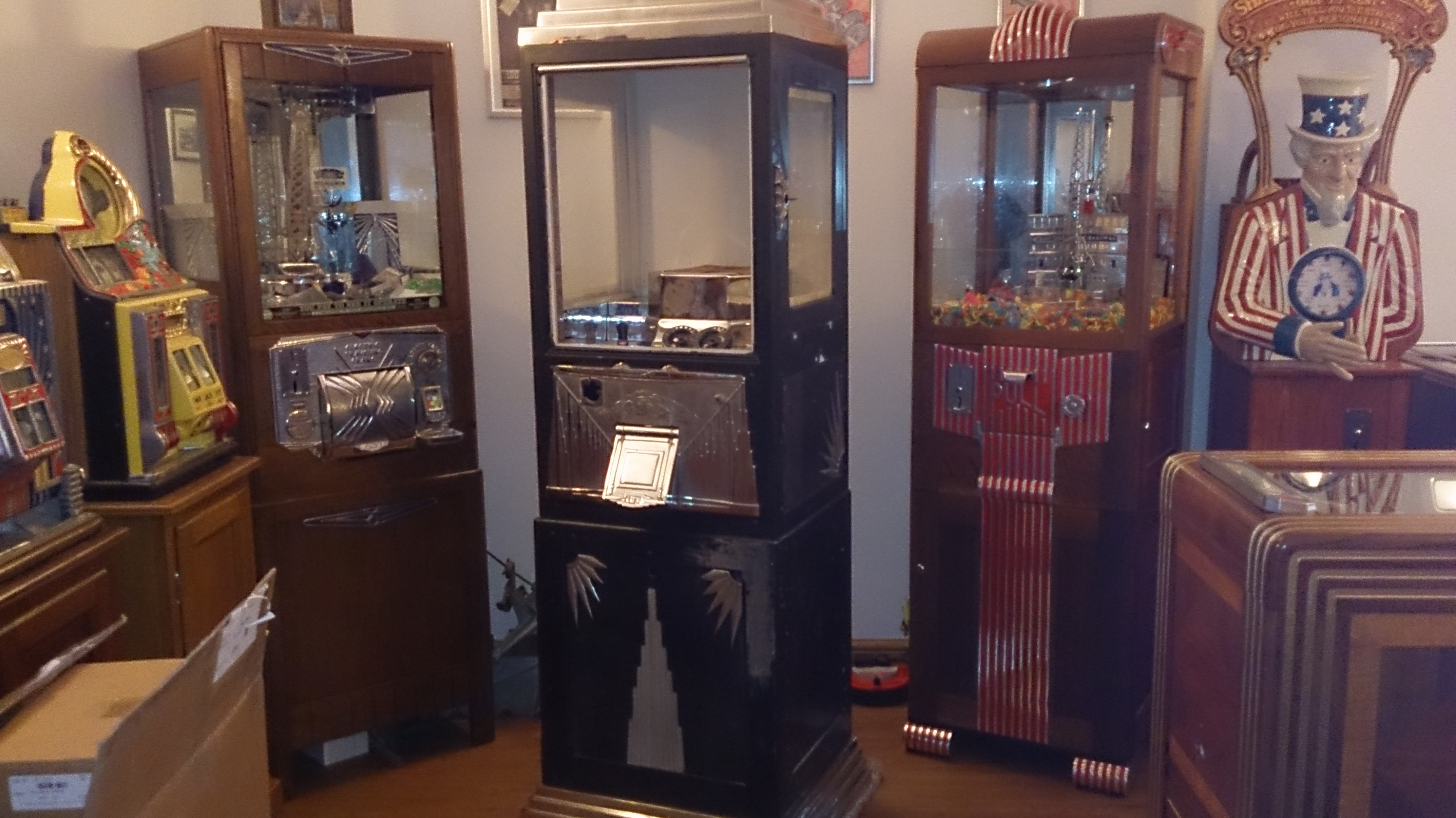

Postby clubconsoles » Sun Feb 09, 2014 3:06 am
diggers on display in gamesroom
clubconsoles
Posts: 264
Re: Something other than a slot machine....
Postby gamblingman » Sun Feb 09, 2014 7:52 am
Wow, nice work! I know what you mean about scarcity of parts. I had to "borrow" several parts from a fellow collector and have then re-cast. The case I had to scrap is a Deluxe upper, so I have a full set of trim. I am re-building the case keeping the trim, as I think those chrome rails and fans set things off. Fortunately, here was a little cheaper. There is a small plating/polishing shop here outside of Chicago that many restorers use. They are just a couple of miles from my work, so I visit them regularly! Lol. I had several of the "fan" trim pieces made out if aluminum, so I have spares. I also have some extra brass cogs from the electrical switch if you need one. Just love these old diggers, and you are so right how the Buckleys can be daunting. I learned on the first one never to go near the chain wheels with anything electric! I had the same experience you did....fortunately Jim Roller bailed me out with a replacement. Beautiful pic, keep me updated on the progress!
