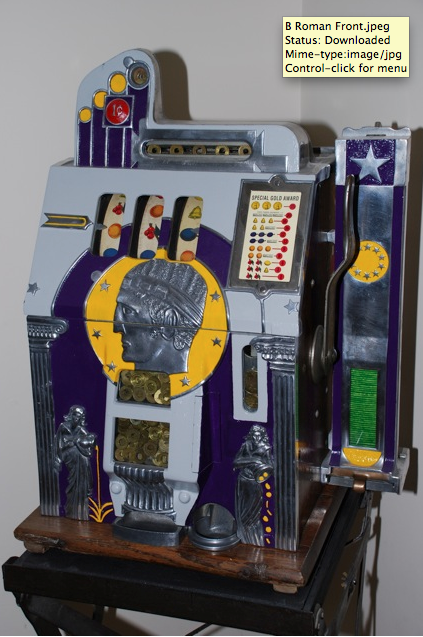

Hey Flip
I restored my original Mills 1ct Roman Front with Gum Vendor a few years back.
This is how it ended up
Best
John
PS not a gum ball vendor but the individual gum stick, like a juicy fruit stick of gum.

Thanks John. Gorgeous machine. Impressive painting and finishing skill. Have not seen a side vender that vends stick gum - wonder if that is normal for the many one cent Roman Heads in US?

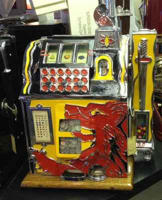

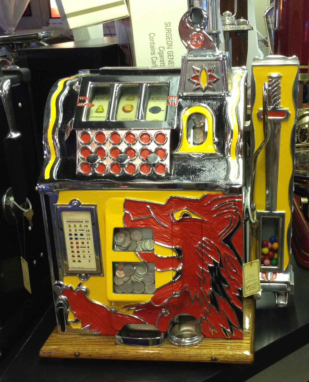

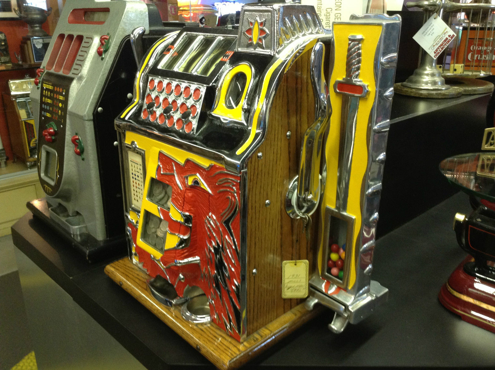

Postby flipper77 » Sat Mar 01, 2014 8:53 am
Continued to ask questions about Penny Side vender for 30's Mills and then saw one on eBay. So maybe Mills did make full sized gumball side vender as some have suggested. Appears to be on nickel machine which seems wrong so is this a fake vender by chance?
