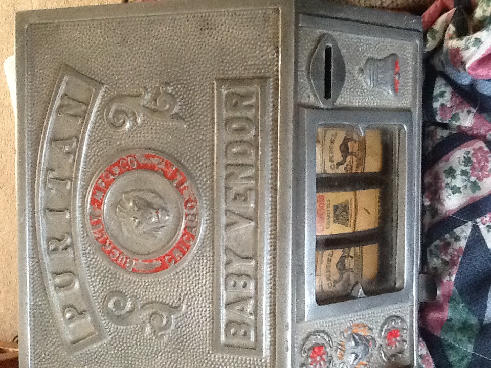

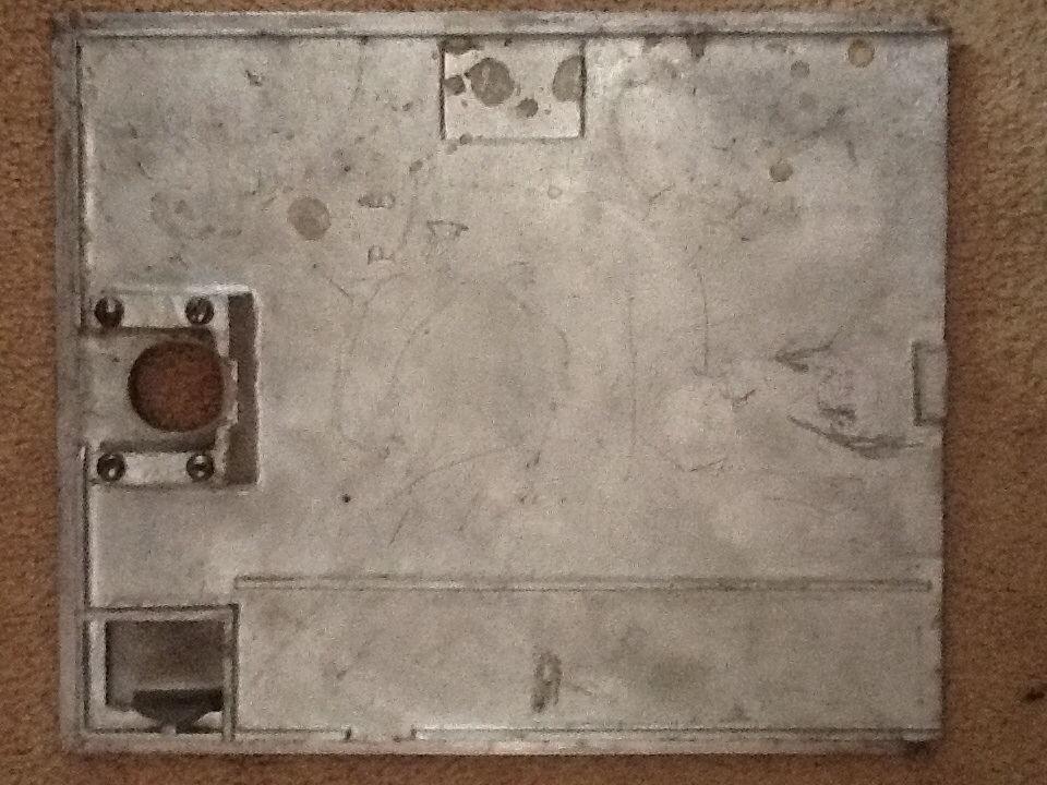

Hi' I'm looking for a lock for this Puritan trade stimulator. Picture below. I know it takes the type that goes on with 4 screws. But all the ones that I can find to purchase on eBay, that look to be the correct ones. Listings always say they are for a mills slot machine. I have asked others that have same machine as mine to send me a picture of there's on the inside. but when they send me a picture of there inside of the back door it's always different from mine. So I don't know if there was many different types put on these same machines or what. Also the hole in my door seens to be a little over sized & a slight oval chapped. I'm new to these machines as I have said in the past. If someone knows about these door lock please let me know. I have not read anywhere that mills had any thing to do with the machine in question.

Your machine appears to be a "Puritan Baby Vendor", of which several manufacturers had a hand in building.
All of the doors were cast aluminum, but all mfrs. did not use the same back door style casting & lock. None
of these doors used a Mills lock, like was used on the Slot Machines. It appears from looking at your door, that
someone has opened the hole larger, for a non-original cabinet lock, or maybe a cam lock, at one time. Is there
a mfr. name within the circle of the top casting? I would also like to see a pix of the front, to see which model
variation you have. I have several different models of this machine, and will check to see which back door has
the same style lock mount that you show, and send you a pix of the lock. I pretty much know which lock it is,
but want to make sure. I have seen these locks on eBay, but not that often.

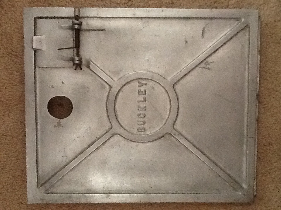

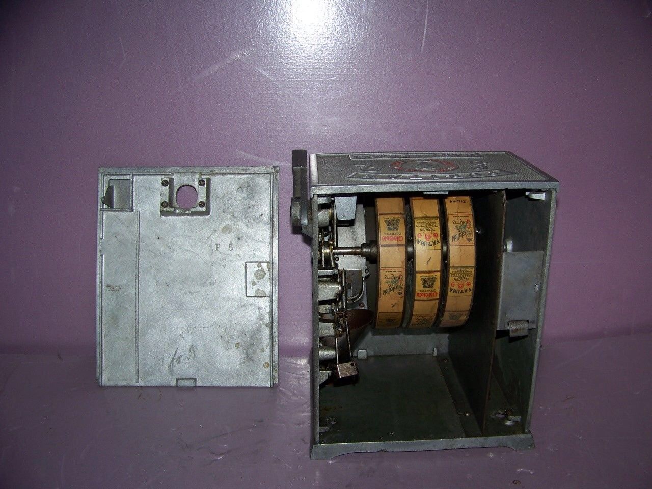

Thanks for responding once again to my needed help. Here are the picture below I think you wanted to look at, you said picture of circle. I was not sure if you meant the Buckley circle on back. Let me know if you need more for verifying. By the way I found a P & a 5 stamped in the inside of back door. Does that mean anything.

I got your PM, and did see these additional door pix yesterday. I checked the machines in the shop, and did not
find one as yet with this exact door. Will have to check the warehouse next. Buckley used two different style
doors on this machine. The other style used a cam-lock. I did find one door with the style lock that you need,
but it was a 2 hole mount, not a 4 hole. There is going to be an additional problem with your door. If you want
it to look completely original, you are going to have to get that hole filled, (that someone drilled oversized),
and re-drill to the correct size, for the new lock. I will go over this more, later with you. I will answer your PM

This is not the lock you need. The barrel is too large.
The hole in your door has to be filled & re-drilled.
