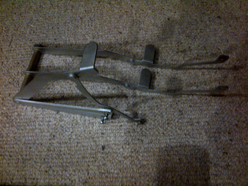

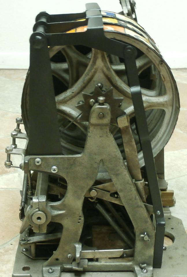

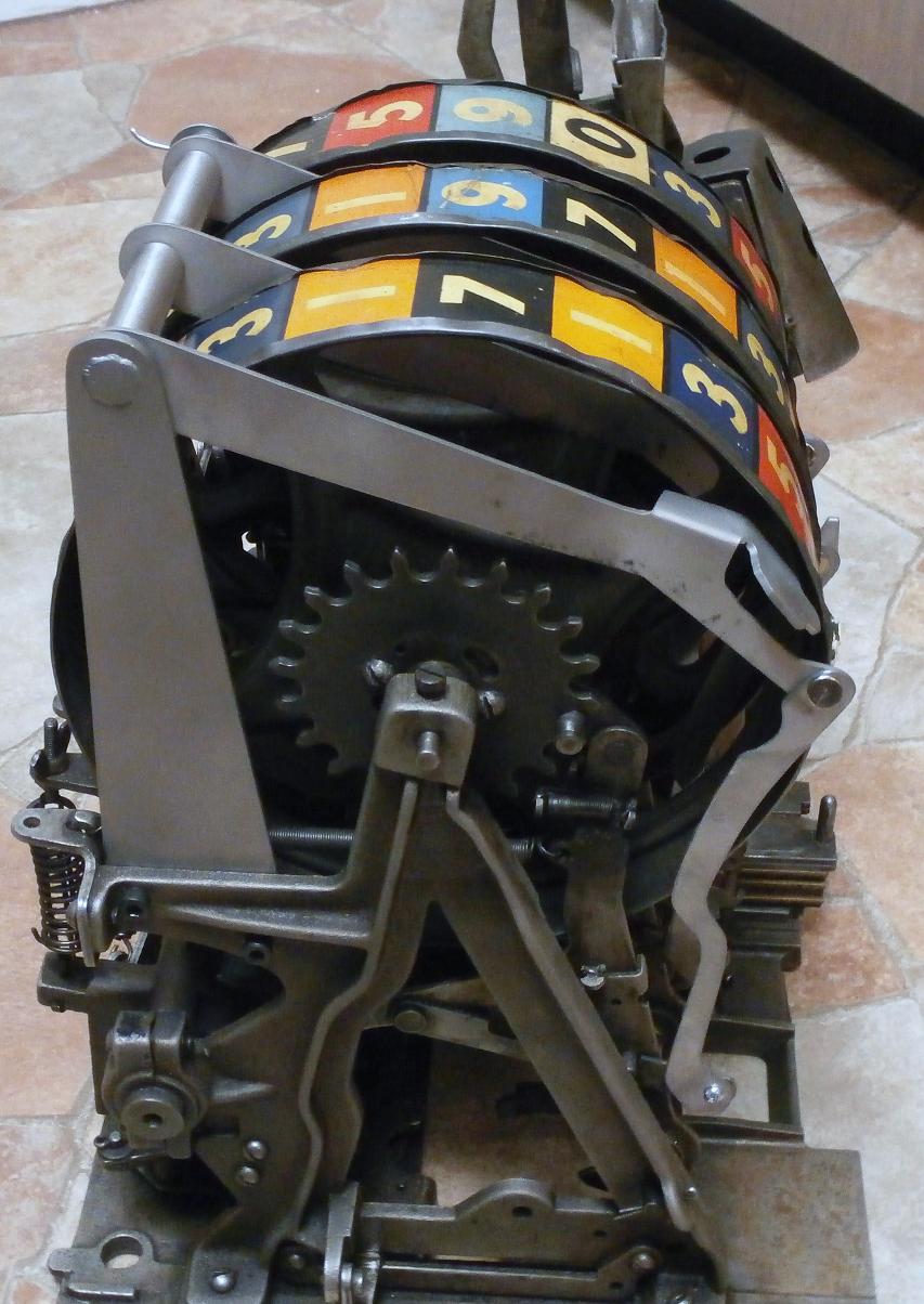

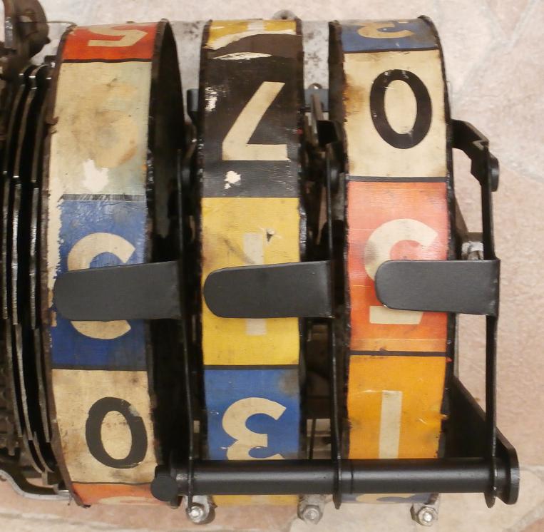

I'll pat myself on the back big time...... I did all the work except the shaft to bracket welding, done by Leon at work.
1262 stop lever connection should have been thinner in each direction.
1254 push levers should have been thicker material.
1263 stop bar actually needed to have the holes off set a little , so it would be closer to the frame. #1 S.L.connection barely touches it.
all holes with a basic drill (not a drill press). all pieces that needed to be bent , were done using a heavy vice mounted on a sturdy table, & a hammer ! (and a little help with a 1/4 inch thick nut for the s.l. connections).
for the push levers, I made a templet to place on each metal pieces ,then etched around it. Then used a few different table top grinders to shape it to the etched lines. And again , bent in a vise.
micro blasted some of the parts. most of the cutting done on a band saw. all shaping with grinders.
much use with hand files for burrs.
shaft & spacers were stuff found a work in the "scrap pile". yep, a multi million dollar company ,& we have to make are own stuff from time to time.

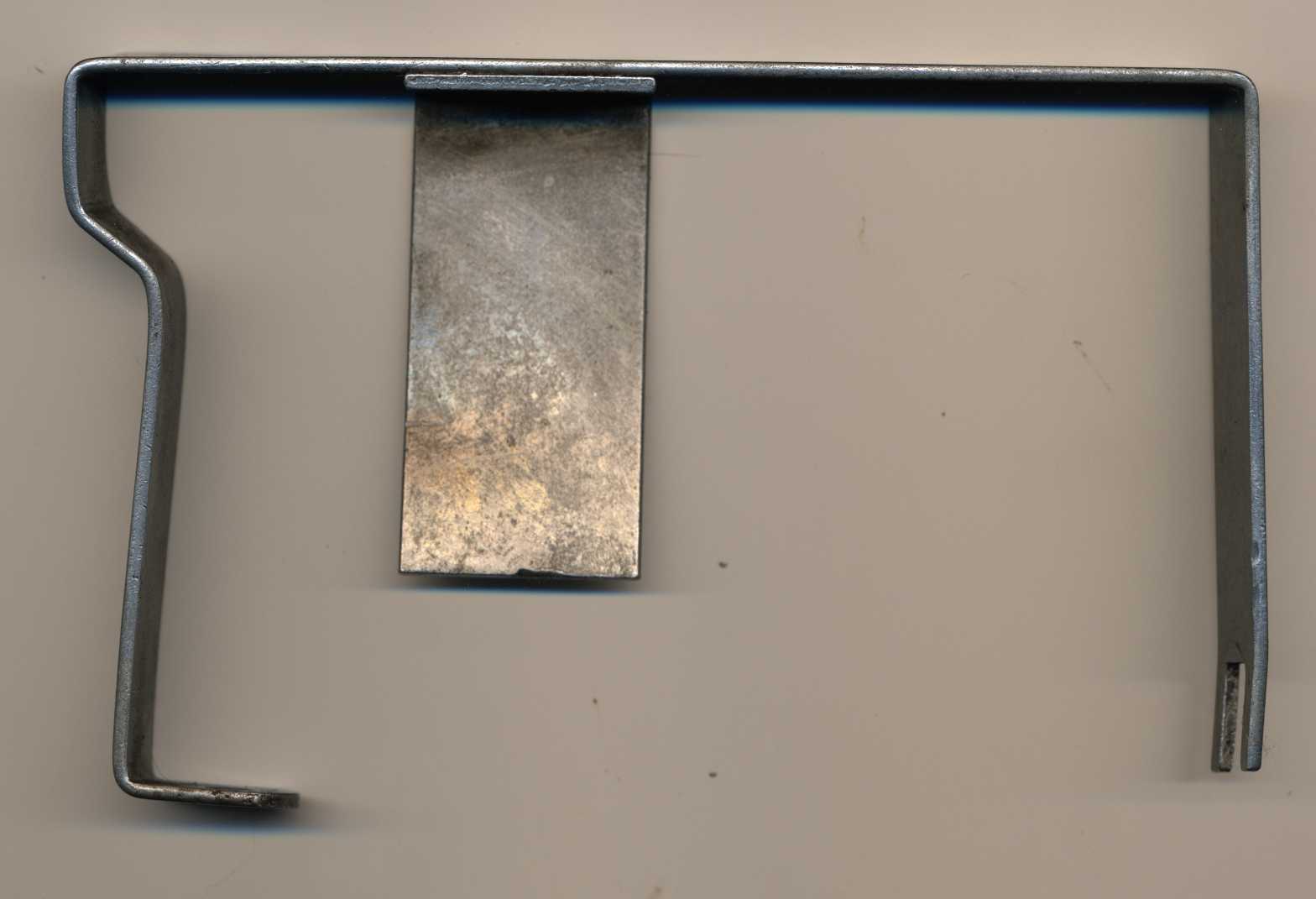

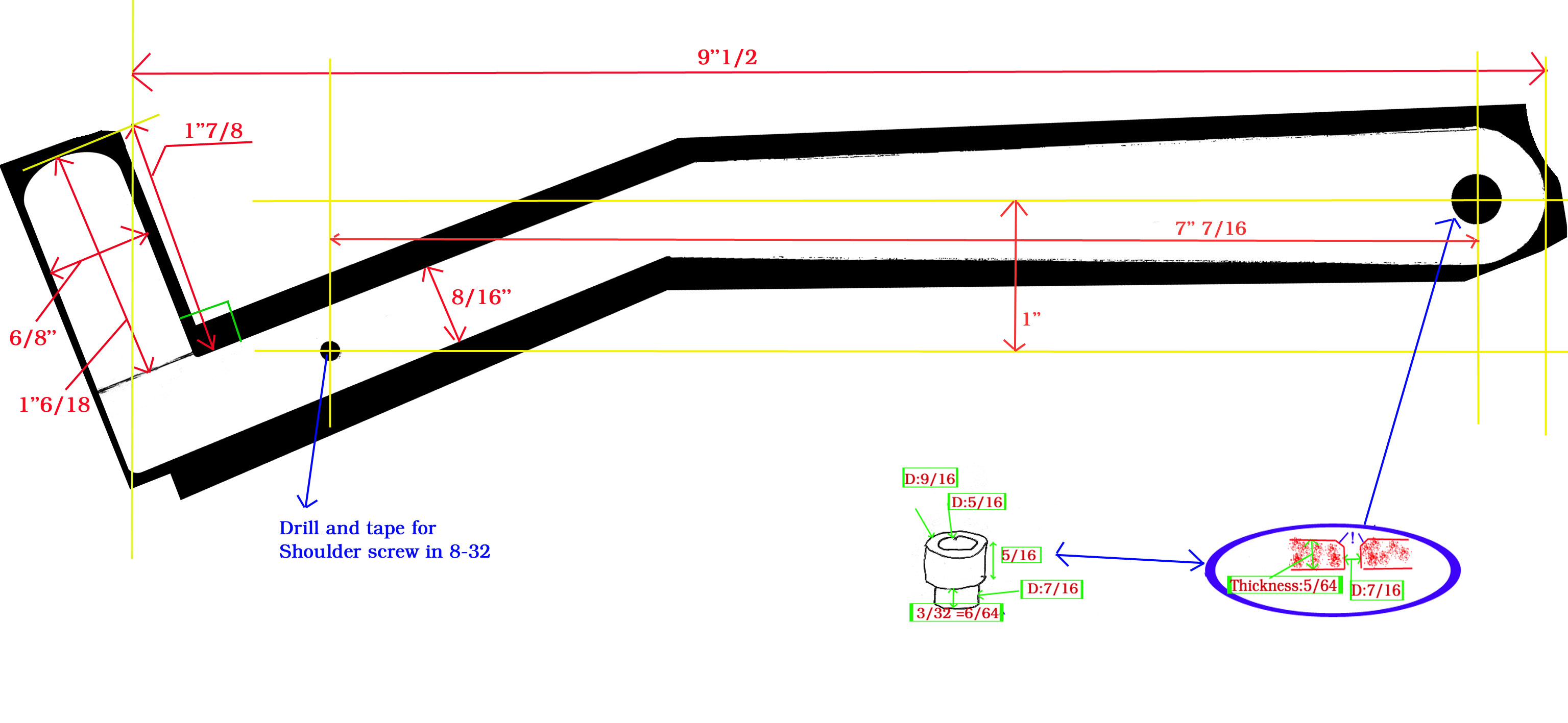

A photo I ran into, but for a front button skill stop system. note just the part #1263, stop bar ! funny bend on the left side, Which would work better for this one too ( even if it's not correct for the era ).

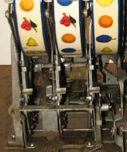

There are 3 different Skill stop style!

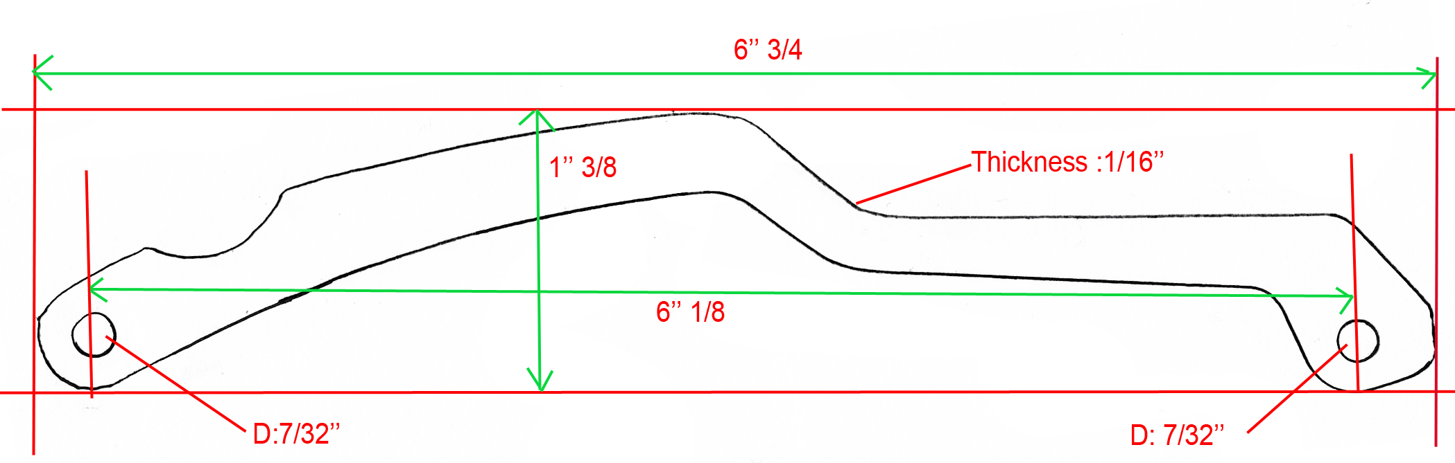

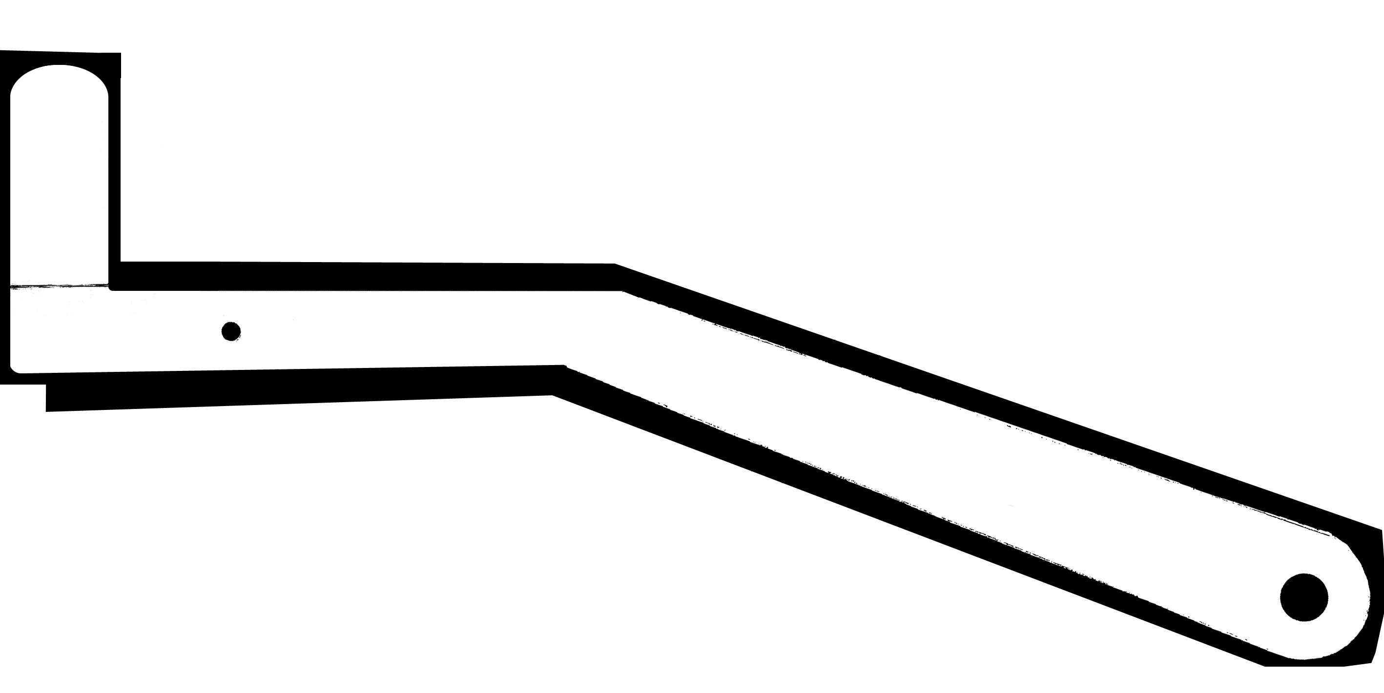

The first: the Top Skill stop, your: FOk ,COK ,Poinsettia English Roman Head,….
Second: The Middle front skill stop, like your last Photo: Extraordinary, Roman Head , Front Castle,…
If I can, I will take the size for this second model .
The third :The Lower Front skill stop .More hard to find than the other .We can find it on the War eagle 50ç,The roman head 50ç ,.... ( two versions of Roman head and War eagle ,Middle and lower skill stop)
All parts are the same on the 3 versions except for the 1254-1262 and 1263.
If someone have the skill stop for lower front to sold, PLEASE, let me know!! I need one set or just the 1254 and 1262 .I will be able to complete my Roman head and make some nice schema ! :mrgreen:

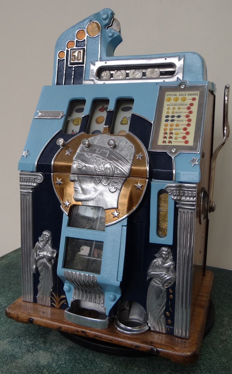

gsx11r
Posts: 242
Location: France, Paris

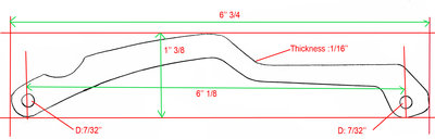

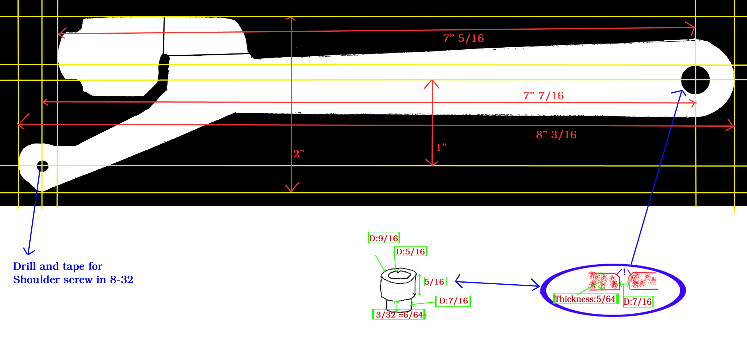

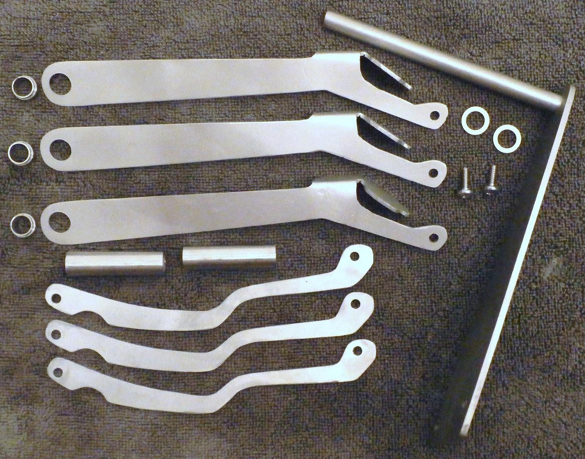

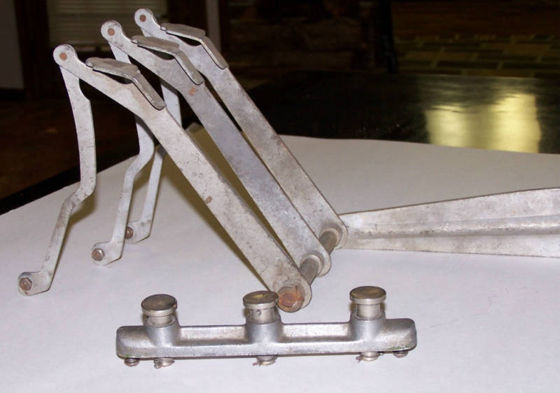

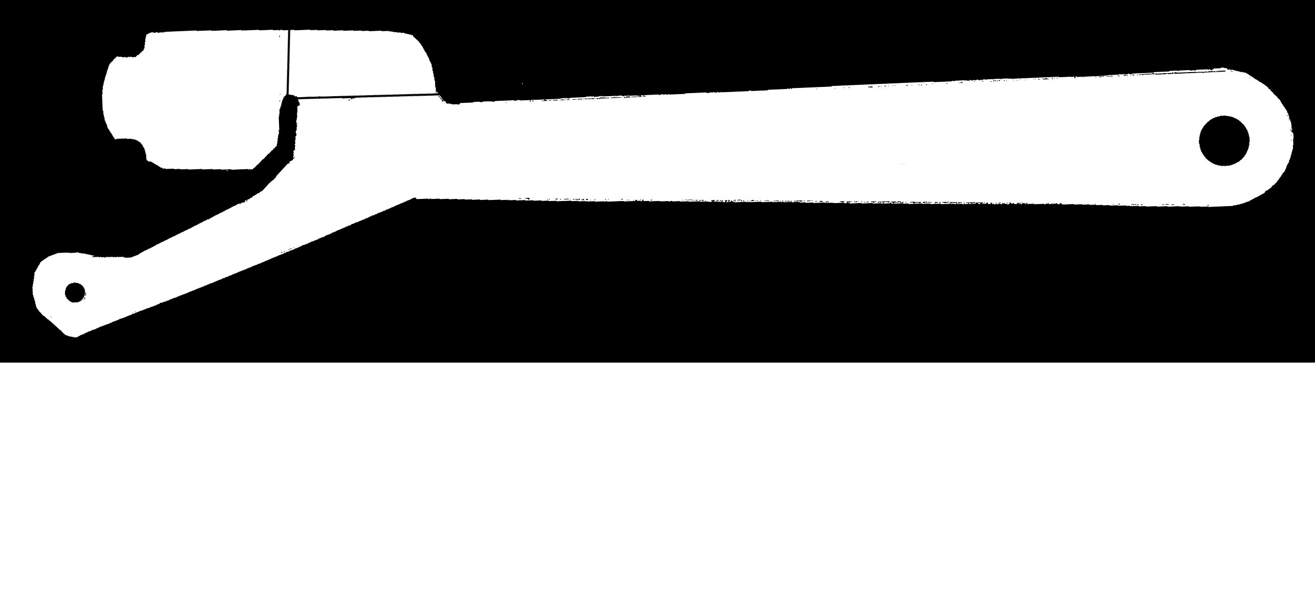

Here is the two parts for the V2 ( Skill on the middle front casting );all other are the same than the V1 !

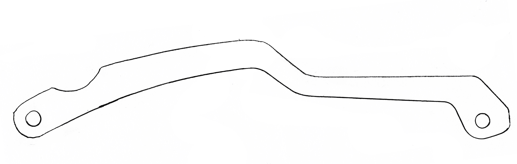

And here is the part for the V3 ( skill under the 3 fronts glass ) ;all other parts are the same than the V2!
A third part (the 1263) is different on V2 and V3 , but I have not at this time ,only one for the 50ç ,so , next episode!
Well , good work !!
Stephane

After getting other things done , finally got around to making these skill stop parts = Version 2 type , for my British Extraordinary. few photos.
definitely much harder to cut & bend verses the first version. I need to find better rivets to connect the 2 pieces.
Also note part # 1263 (stop trip lever) not in these photos. I didn't make it till the next day.
jeff H
