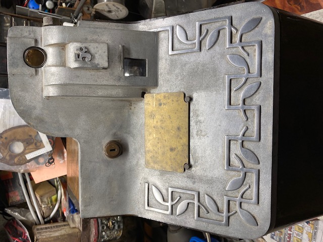

Postby bkrsdoz » Sat Nov 29, 2025 8:40 am
I am restoring a Mills QT Smoker that had the front casting stripped.
I know the color should be a brown with a textured or hammered finish.
Does anyone have experience with a Rustoleum color textured or hammered that would be a close match?
I have polished up the relief casting details, and am ready to start painting.
Thanks, Bob

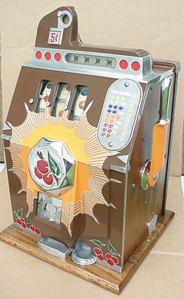

Postby radiorich123 » Sat Nov 29, 2025 9:27 am
Did this one in regular rustolium paint.
Posts: 576

Re: Mills QT Smoker Paint Color
Postby bkrsdoz » Wed Dec 03, 2025 7:41 am
Radiorich,
I am curious what Rustoleum color you chose to repaint the Brown Front?
I am trying to decide on a brown for my Smoker.
I like the Rustoleum flat Brown, but I don't know if the casting itself will show enough texture.
I was thinking maybe do a texture paint underneath, then the flat Brown over that, then a satin clear?
How do I remove all of that from the relief design afterwards?
I was thinking a clean white t shirt with just a little lacquer thinner and my finger tip?
Tedious, but I want to do the best I can.
I was lucky to find it!
Thanks,
Bob (bkrsdoz)
Postby radiorich123 » Wed Dec 03, 2025 8:11 am
It was Rustoleum leather brown.
