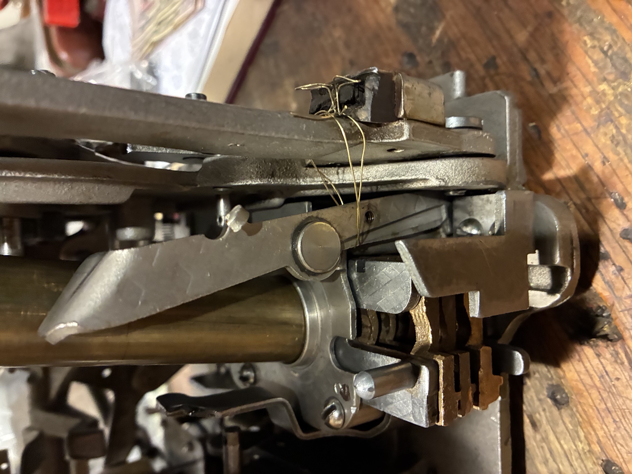

On my point number 3, just to make sure the anti-cheat lever doesn't move back, you can secure it with a thin piece of wire. They usually don't fail, but I've had a couple of machines where they did fail. See my attached photo where I did this to a customer's machine, where the lever kept failing.
The problem is probably weak slide springs, or the payout slide cover bolts are too tight - good luck working on your machine when you get back from your trip.
