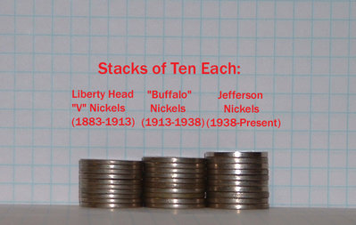

Postby marsonion » Thu Dec 20, 2018 8:29 pm
kentdun wrote:Some payout cards listed a range of payouts. 2-4 , 7-9, etc. Covered the operator for short payouts.
Which may have been a necessity because, by 1939, any slot player would likely have been carrying a random mixture of the three varieties of five cent coins shown here. Look how our money has grown! For an orange/ten payout, there was nearly a 1/8" cumulative difference across 25 years for the coin slides to accommodate. I hope someone possessing a nice collection of original Washington quarters (1932-1964) will post a similar comparison with the post-1964 equivalent... I've only got three of those junk silver quarters handy.
