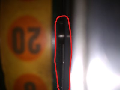

Please, I need help with my Chicago Club-House. Could someone tell me where the dock that triggers the opening of the gum is? I have connected it to the base screw, it works well but it rubs on the reel.

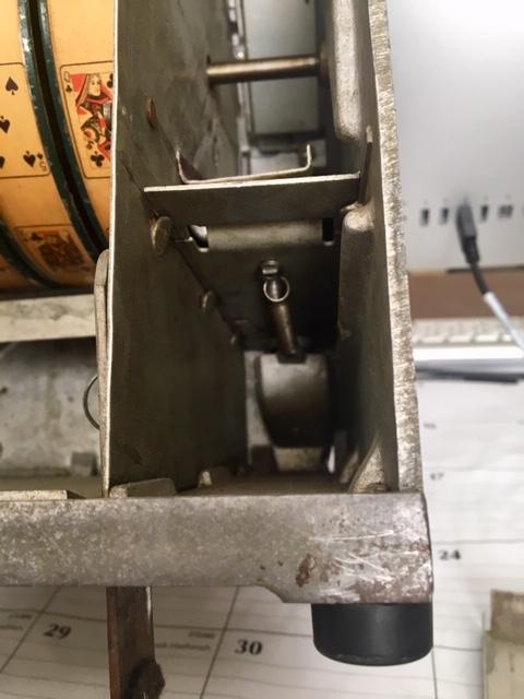

Postby nvmos2 » Thu Jan 10, 2019 11:11 am
Not sure what the dock is, but I'm sure that the spring should not be connected to the base screw.
If the dock is the sliding plate that slides forward to release a gumball then is pushed back by the rod (on front of machine) to reset it,
then the spring is hooked to the back end of the gumball chute.
hope this helps.

Thank you very much Nvmos2. No, that is not the spring that I was referring to.
The spring that I say is the one that is on the axis of the reel. That releases the button of the chewing gum, when they want the reels.

Postby nvmos2 » Fri Jan 11, 2019 3:14 pm
Yes; I understand now;
There is a small hook on the side of the gum compartment wall;
about 1.5 inches (sorry; I don't have an inches to millimeter conversion chart handy) below and slightly forward of the reels' center axel rod;
the end of the spring should be attached to that hook.
The correct spring appears to be much smaller than the one on your machine.
I think somebody put it together and didn't have the correct spring, so they just stretched it down to the base screw.

Postby rupohe » Sat Jan 12, 2019 2:12 am
Thank you very much Jim. I imagined that something was wrong. the spring is too long. I had already noticed that small hook but the spring made me doubt. I will cut the spring to the correct size.

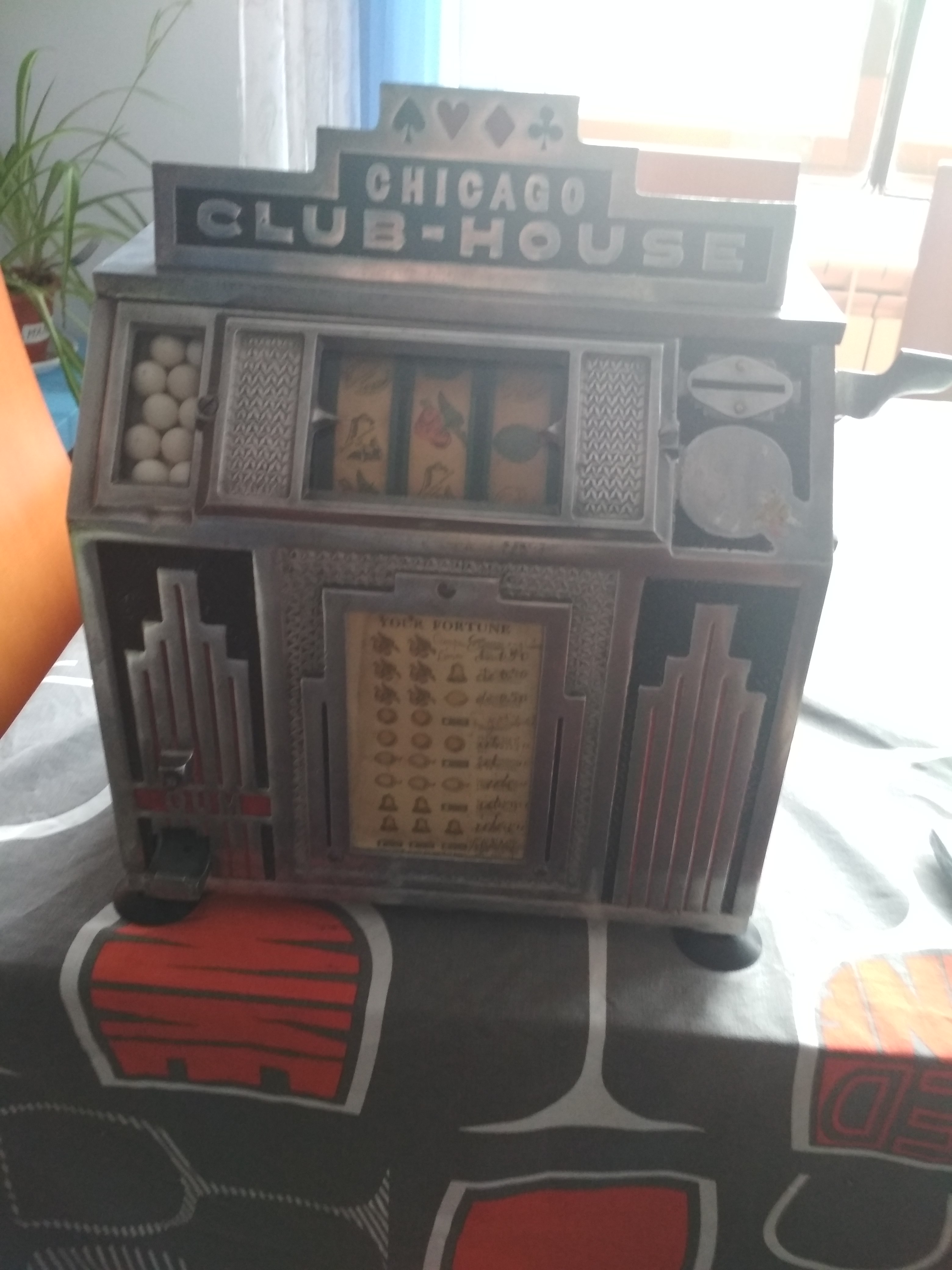

I'm also doing a gold medal decal, is your decal in good condition? I copied one that did not have much resolution, I will try to reproduce as best as possible and put it in the forum for those who need it

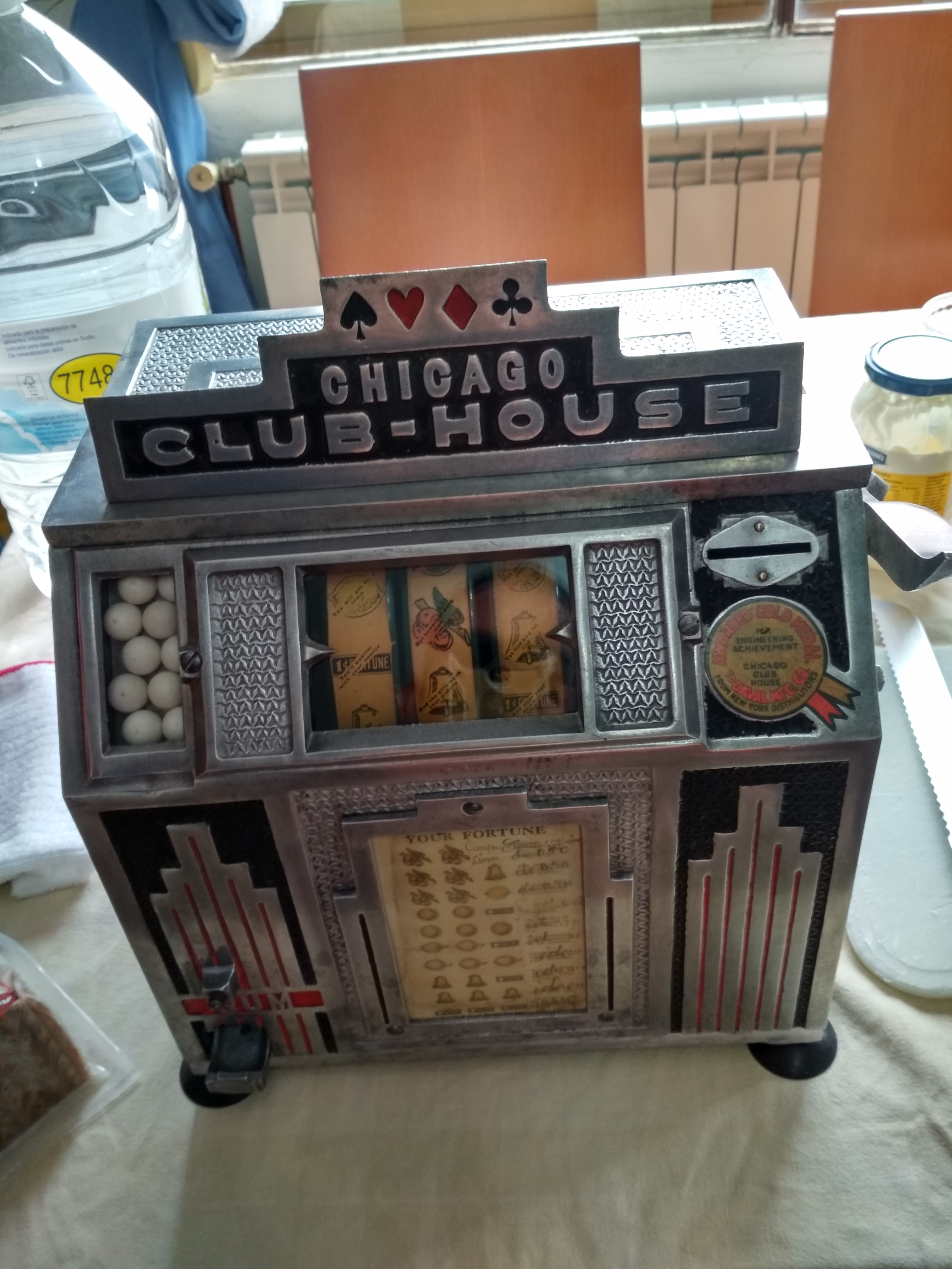

Postby rupohe » Sat Jan 12, 2019 12:06 pm
My daval, I do not know what version it is, because I can not find the serial number. It may be because it was destined for the foreign market. It is made for Spanish currency of the time.
It is a prototype of a retouched decal. I'm going to try to design a decal.
