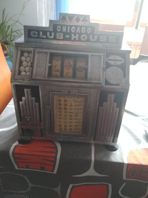

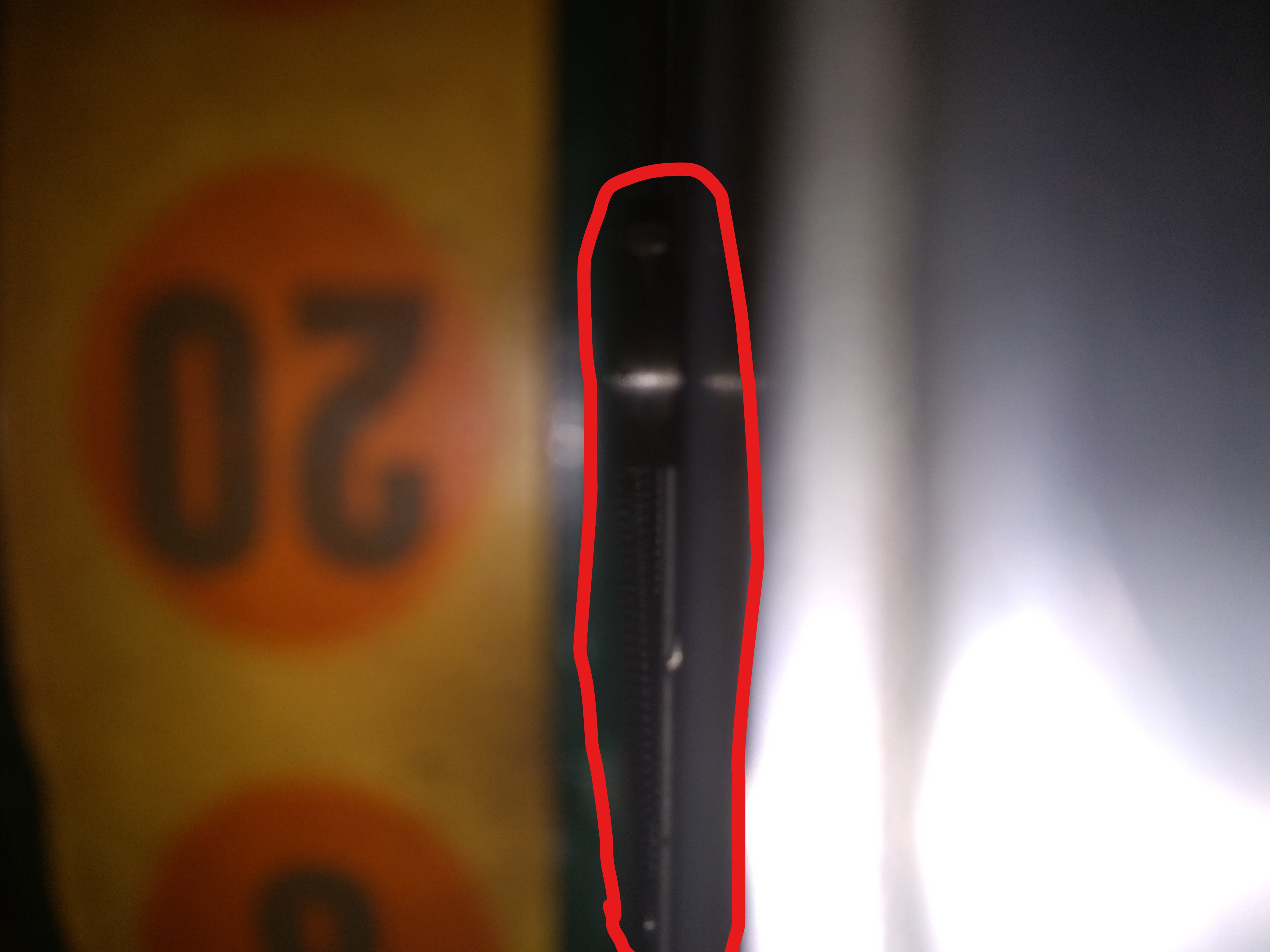

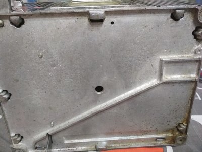

Please, I need help with my Chicago Club-House. Could someone tell me where the dock that triggers the opening of the gum is? I have connected it to the base screw, it works well but it rubs on the reel.
Thank you

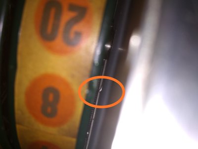

Thank you very much Nvmos2. No, that is not the spring that I was referring to.
The spring that I say is the one that is on the axis of the reel. That releases the button of the chewing gum, when they want the reels.
To make it look better I would have to disassemble the side part

Yes; I understand now;
There is a small hook on the side of the gum compartment wall;
about 1.5 inches (sorry; I don't have an inches to millimeter conversion chart handy) below and slightly forward of the reels' center axel rod;
the end of the spring should be attached to that hook.
The correct spring appears to be much smaller than the one on your machine.
I think somebody put it together and didn't have the correct spring, so they just stretched it down to the base screw.
Jim
Re: Chicago Club House
Postby rupohe » Sat Jan 12, 2019 2:12 am
Thank you very much Jim. I imagined that something was wrong. the spring is too long. I had already noticed that small hook but the spring made me doubt. I will cut the spring to the correct size.

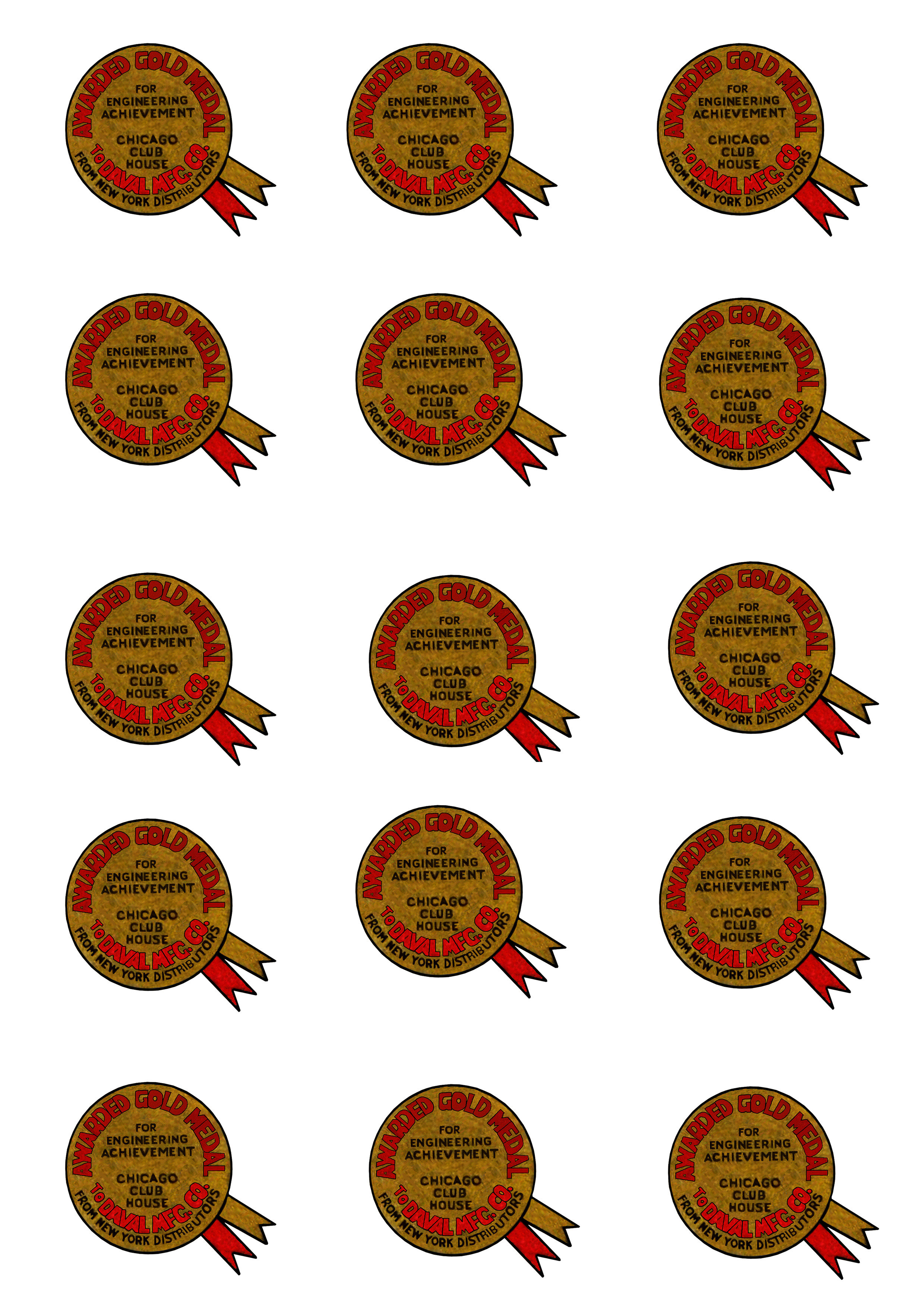

I'm also doing a gold medal decal, is your decal in good condition? I copied one that did not have much resolution, I will try to reproduce as best as possible and put it in the forum for those who need it

Postby nvmos2 » Sat Jan 12, 2019 10:21 am
Early versions of the Club House did not have the decal; my machine does not have it.
"In a clever marketing ploy, Daval gave themselves a Gold medal 'For Engineering Achievement' ostensibly awarded by their New York Distributors in November 1933." (Bueschel)
"The Gold Medal emblem decal quickly wore off."; rather ironic since it was for engineering achievement.
I don't know if the decal has already been reproduced, but there are probably other collectors who could also use a replacement.

Postby rupohe » Sat Jan 12, 2019 12:06 pm
My daval, I do not know what version it is, because I can not find the serial number. It may be because it was destined for the foreign market. It is made for Spanish currency of the time.
It is a prototype of a retouched decal. I'm going to try to design a decal.

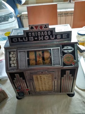

Postby rupohe » Fri Jan 18, 2019 11:45 am
They are finally finished. Thanks to everyone who helped me. It only needs to regulate the sprue, but that will be for the next time.
I enclose a few decals, in case someone wants to take advantage of them or modify them.
