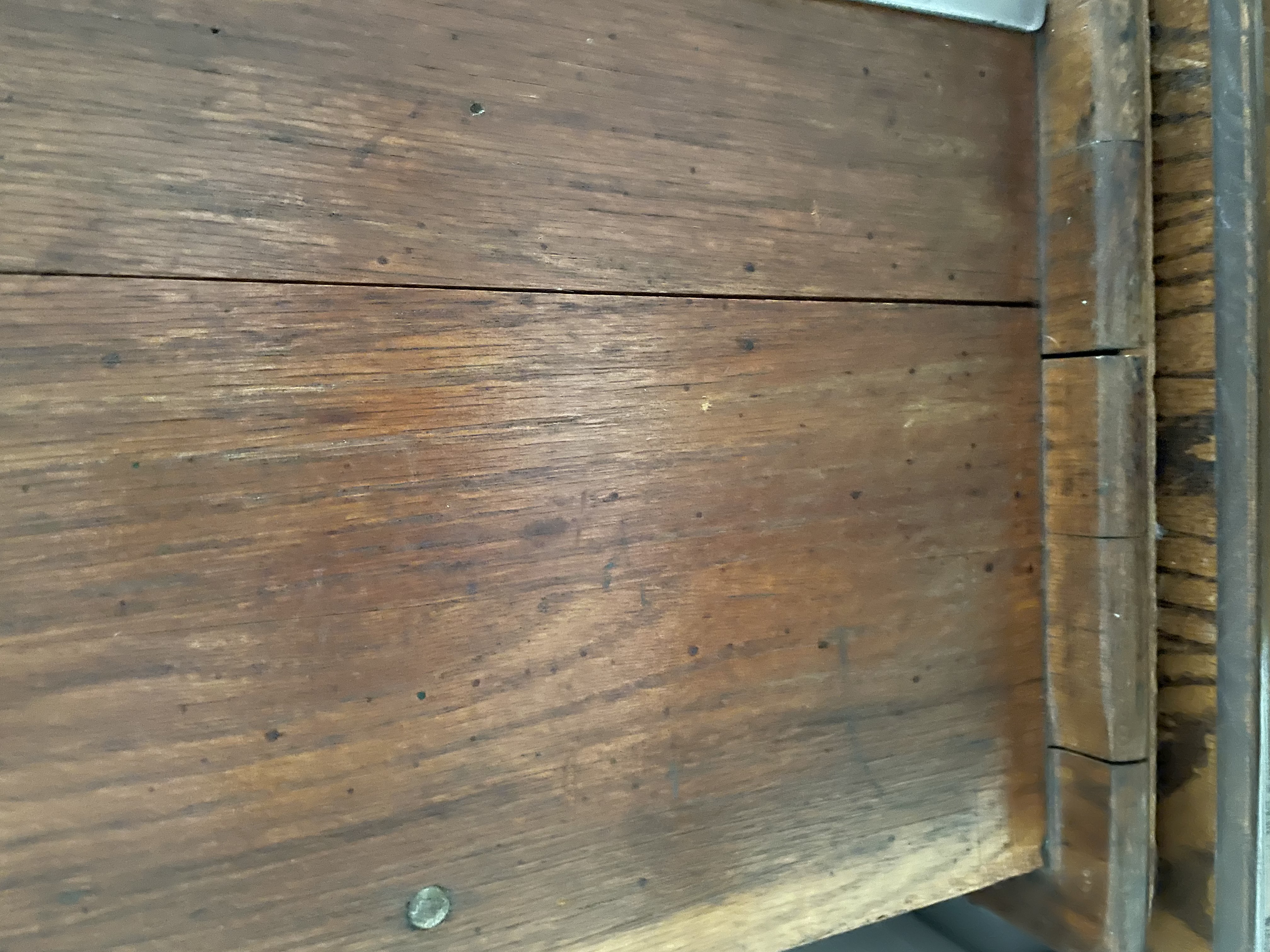

Looking for advice on solutions for splits in the base and sides of the cabinet (see pic).
The cabinet still seems structurally strong but would look better if the splits were smaller or gone. I don't want to take the cabinet apart.

The splits are from the wood shrinking over time. The best way is to cut and glue thin veneer strips in the splits. Use walnut or oak veneer that match the original wood color.

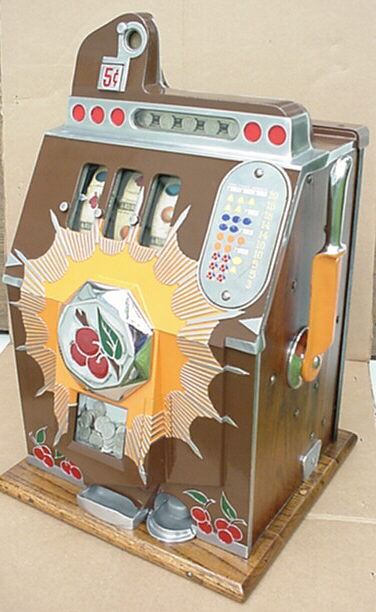

Yes wedge and glue the strips in. I would not take the cabinet apart. If the cab finish is bad then strip it and refinish it. Here is a photo of one that i did.
