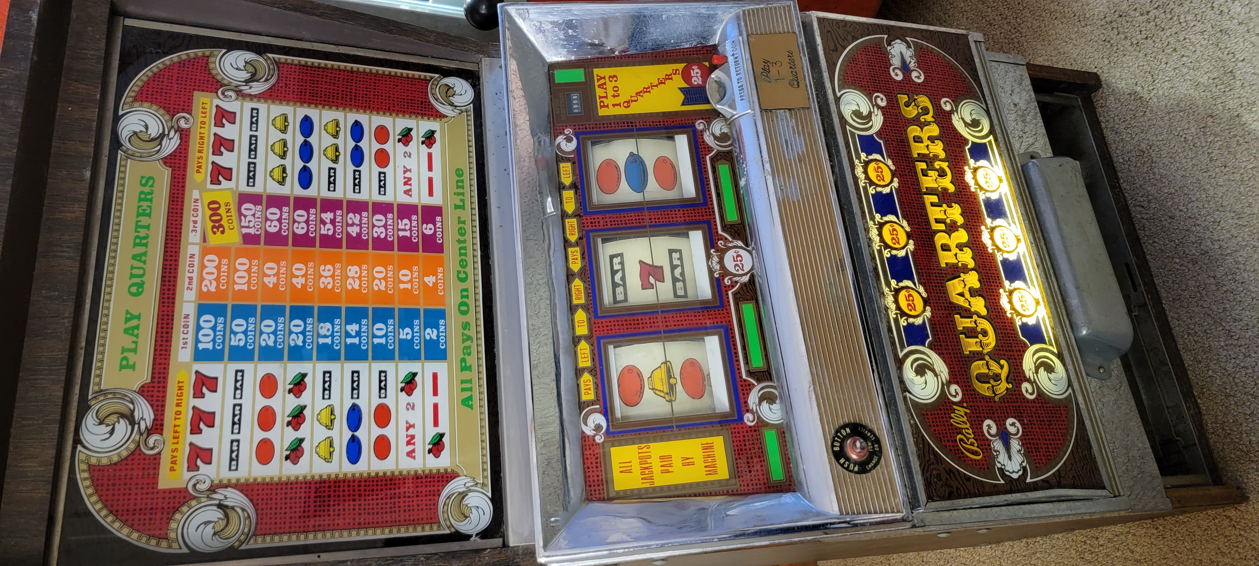

Today I purchased my first slot machine but I know next to nothing about them. I have attached a photo.
What I know so far...
There is no ID plate where I have read that I should expect one. So I don't know the model number. It looks similar 1970s Era ones online. I though maybe a "1088" but when I looked up a manual it was for a video machine. Any help with model number and where I can get a correct manual would be greatly appreciated.
My 4 year-old and I blew through about 50 quarters today. We had a couple wins but no payouts. Cherries didn't pay out, not did getting triple blue (grapes? Olives? Whatever the are?).
Additionally, sound doesn't work, nor do the top lights.
The bottom collection tray is missing.
The left cylinder seems to have dents in varoous places.
The center cylinder sometimes does not rotate very much.
Apologies if I am using the wrong terminology. Literally this is my first day with it. Any suggested books or links to repair manuals?
Thanks in advance.

Did you get a key? Can you open it and show the inside guts? AKA mech. It’s a Bally case but may be a summit conversion.

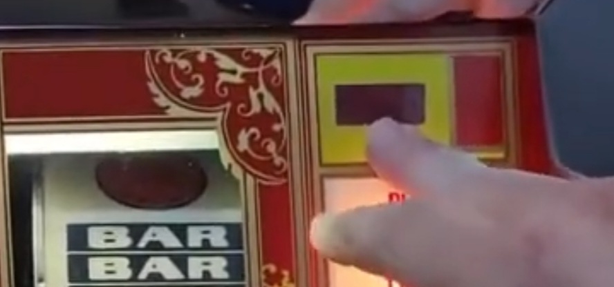

Mechanical Win Meter
I still have yet to open it, but I am guessing it is not a summit conversion because if it was, I think the win meter on the top right would be a LED instead of the mechanical counter that I have.
(Based on this video about a specific summit conversion ...
https://youtu.be/amhGkwX7OBg?si=lnjlPe78oqE13sGn )
LED win meter (from video)
Can anyone confirm that logic?
john@alaskajohn.com

Now, the sound. The only sound that the machine should have is possibly a bell that rings with a jackpot or high pays. Unless it's an E-series machine. But it appears to me that it is just a standard EM machine.
