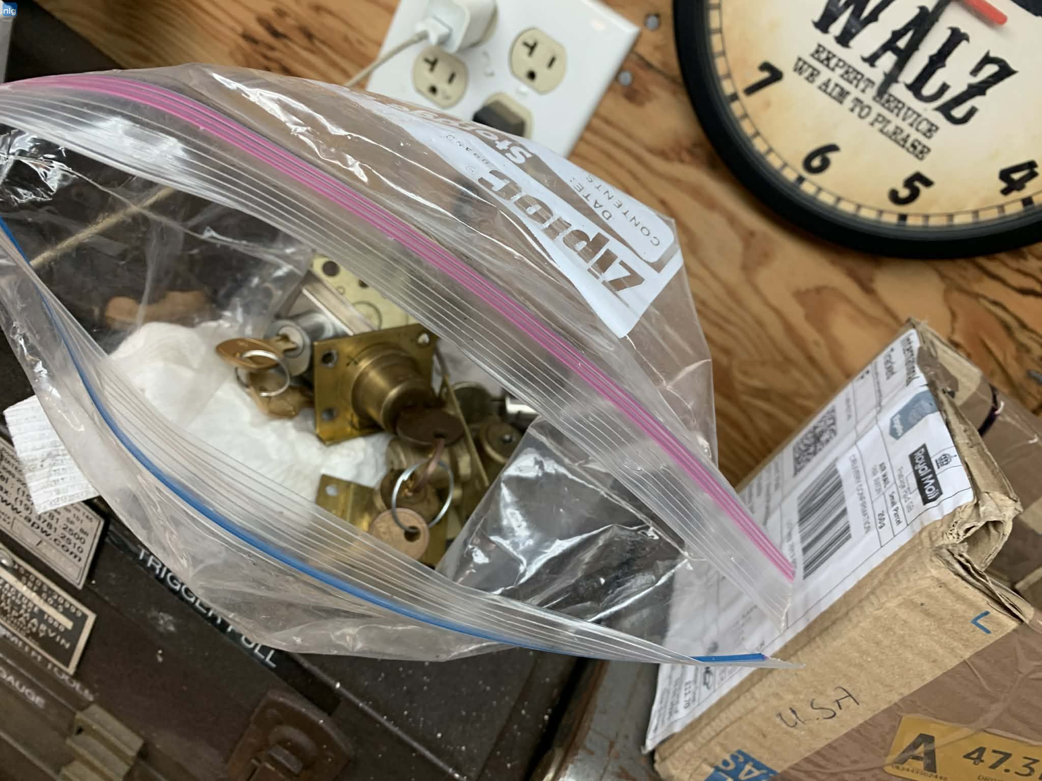

Postby 99623 » Wed Feb 18, 2026 6:55 pm

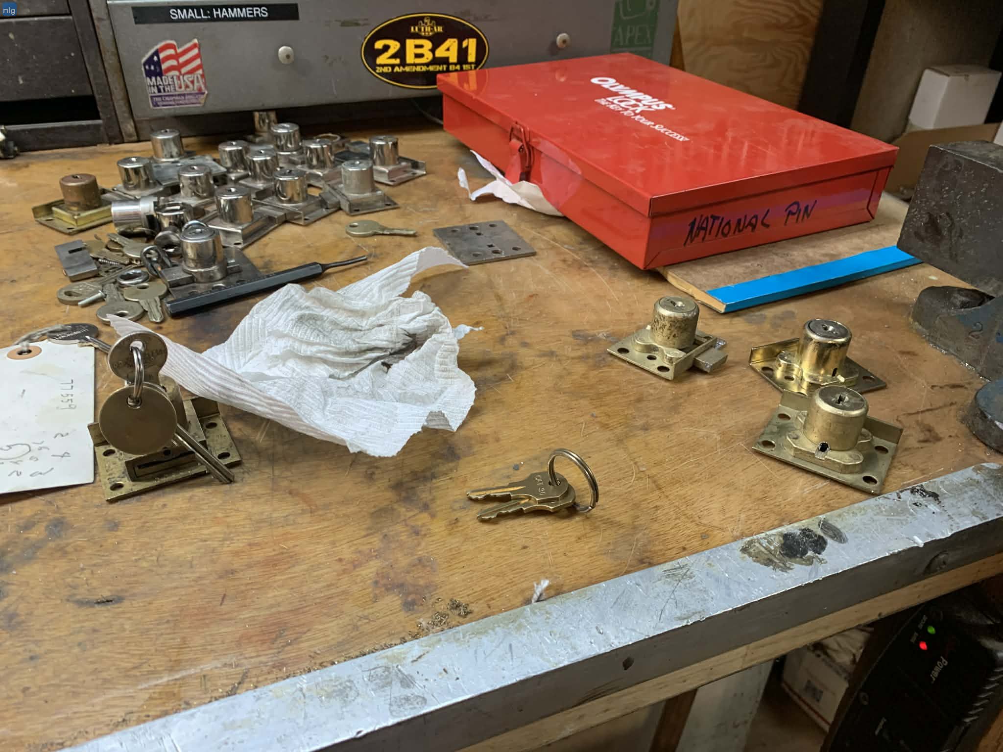

I just got another shipment of slot machine locks. Each lock manufacture has it's own unique assembly.
Yale locks are a bugger to shim open with the spool pins. They are a six pin lock, which is unheard of today, and the keys are unique.
ACE locks, well they are held together with a pressed pin and if you don't drill the pin just right you are in a world of poop.
National pin tumbler locks are similar to the Yale.
Mills is not all that bad since I remembered a lot from my youth working on them. The most important thing is making scribe marks for disassembling each lock parts. If not you will be in a world of poop. The variation of Mills locks is another factor that can cause a hiccup also.
The real challenge is the DUO locks, that is the most difficult lock to make keys for with the opposing tumblers, The hidden wire ring holding everything together, it's a nightmare. I am still trying to re-engineer the lock assembly and my options are limited.
On with the show.
The good part is that the customer has sent me some locks that were damaged, this is a excellent source for parts, salvaging other locks.

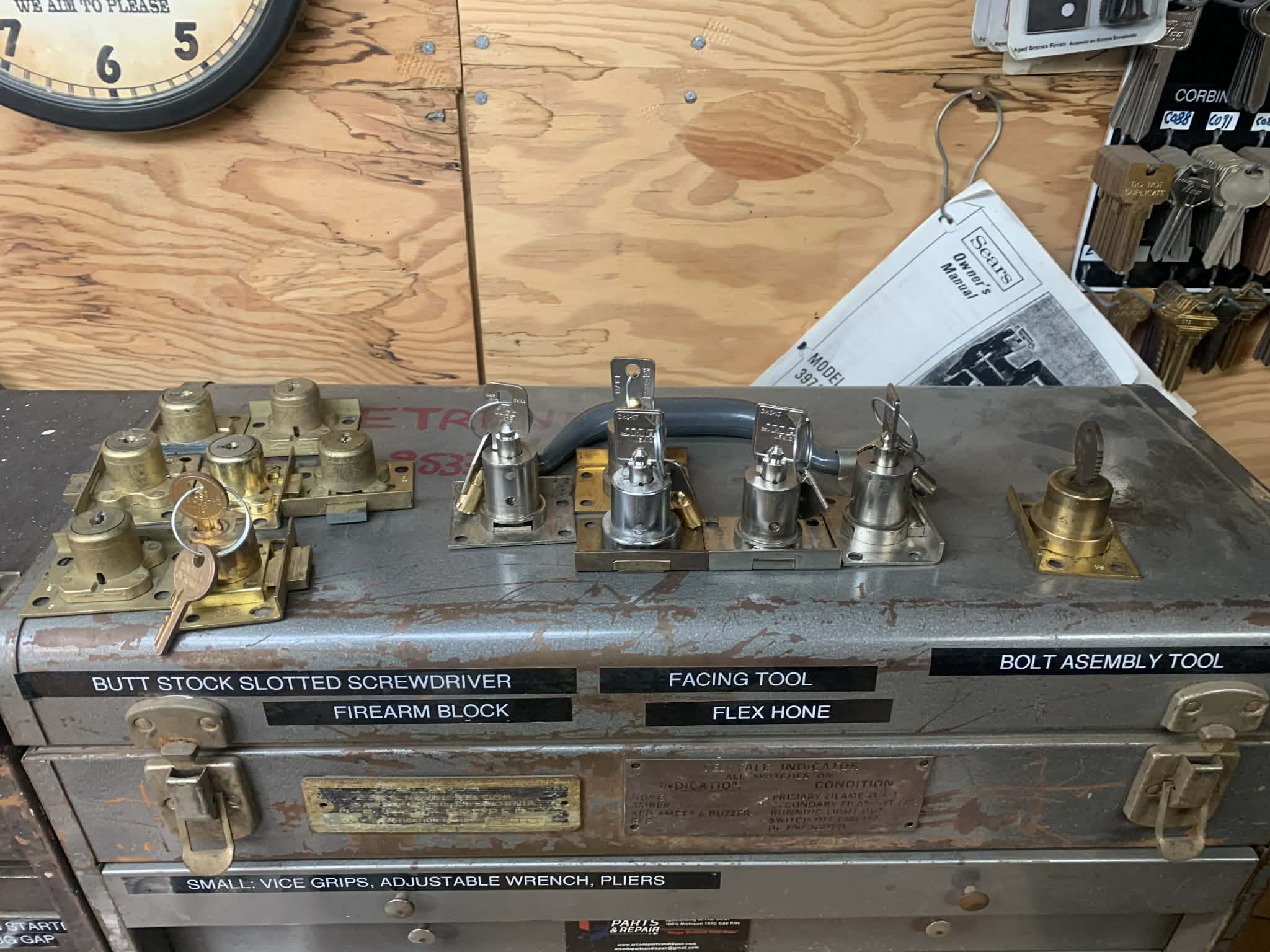

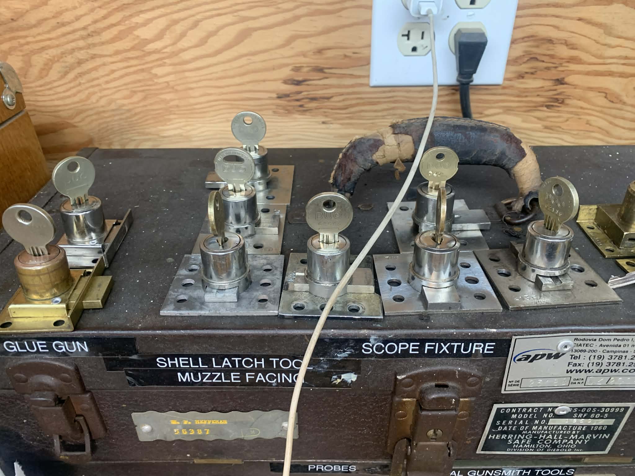

Well, it's been a interesting journey with these locks, I have got a lot of locks rekeyed.
The DUO is the only one that I can't do much with, they are extremely difficult to work on, I just fit a key to the locks. I had to make a fixture to take them apart and a cylinder set up fixture to assembly them.

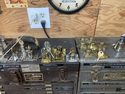

These are the DUO locks.

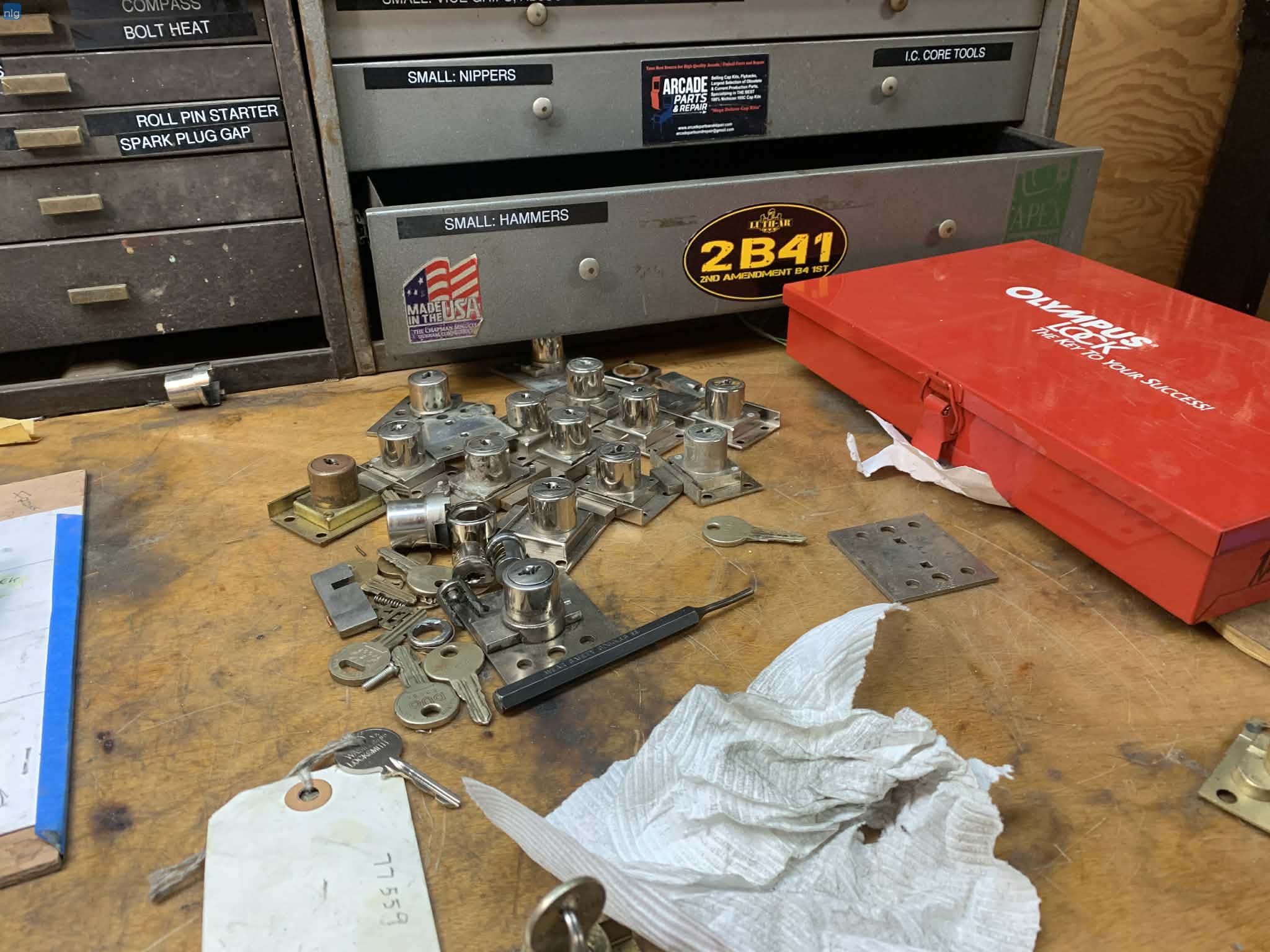

These are the Jennings locks, and some other cabinet locks.
These are Jennings Club Chief ACE locks, Mills locks, and some of the cabinet locks.

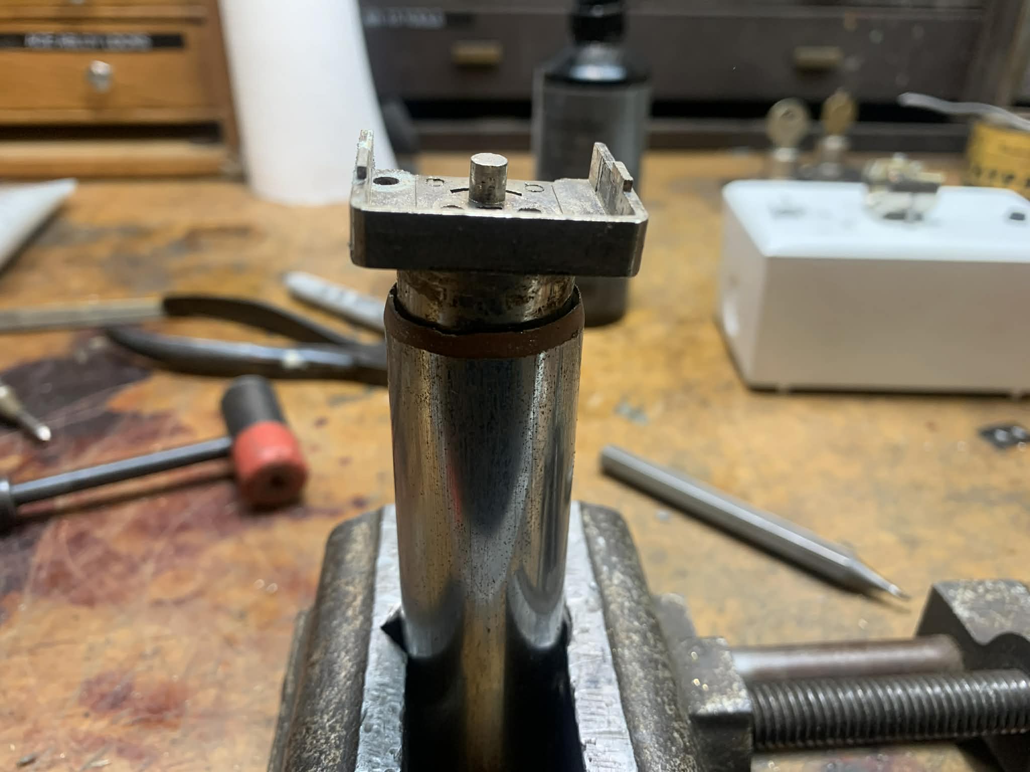

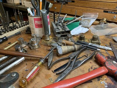

A lot of the locks are keyed alike, it's easier to keep everything constant, I have some key blanks coming in so duplicating them will be fast and easy.
This is one fixture to remove the cylinder. You can't remove the cylinder any other way, the lock mechanism is brittle, and will fall apart, I learned it the hard way.
The other photo is the assembly fixture.
