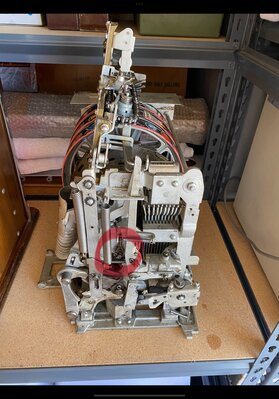

First you to have to free the handle. There is a ratchet on the side of the mech. Use your finger to release it as you slightly pull on the handle.
Once it’s released, try the machine with a coin. A lot of the Jennings have Anti Cheat parts that’s cause the machine to seize up when played without a coin.

Postby Swami » Tue Sep 03, 2024 2:05 pm
Don’t force anything…You will break it. Here’s a picture of what needs to be released. See the RED circle. Then play it with coins.

Postby midohioslotmachines » Tue Sep 03, 2024 3:56 pm
The handle is un-stuck, works fine, however when I put a coin in it rejects the 50 cent everytime. coins move across the escalator normally, but still rejects coins
