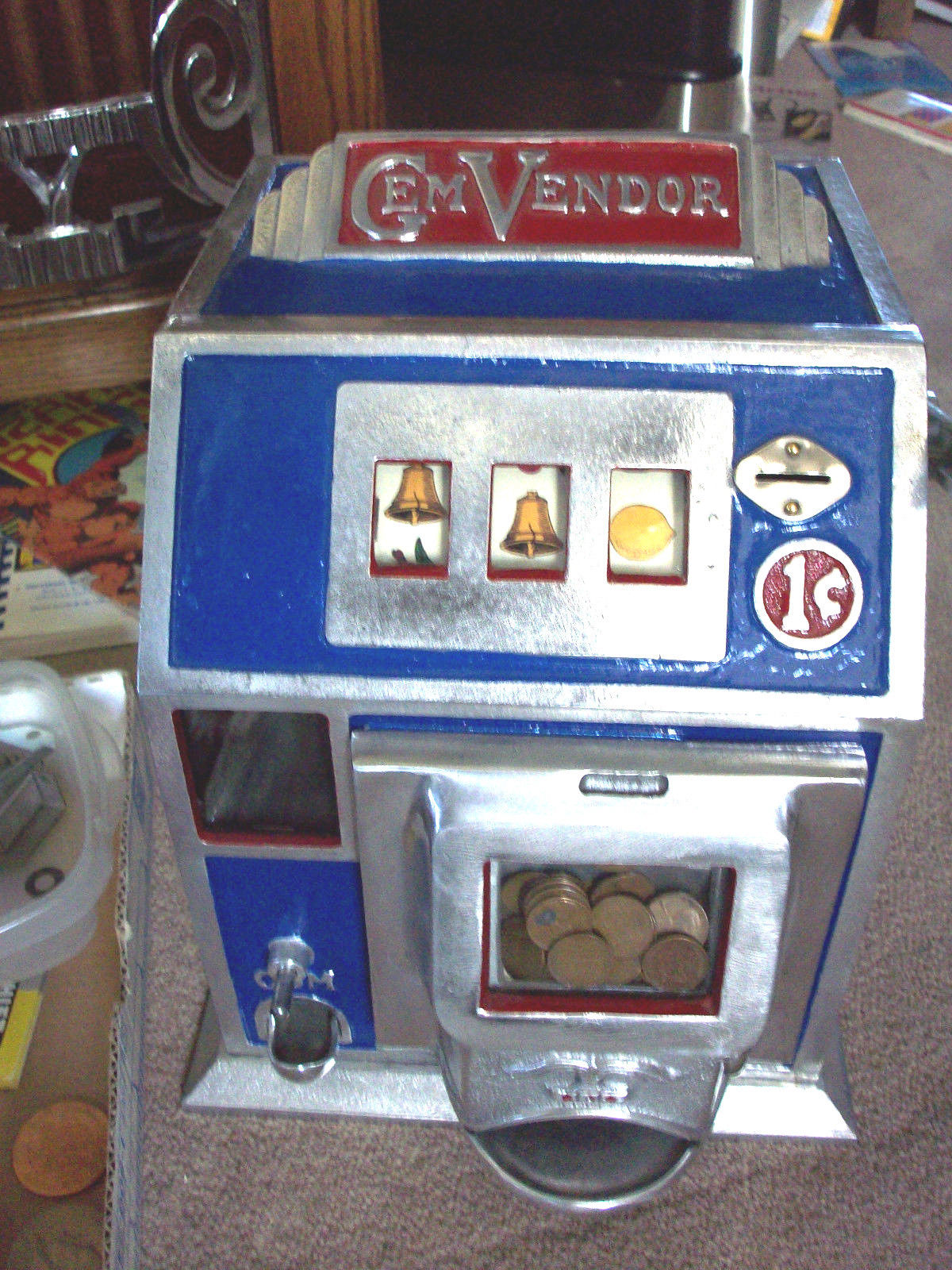

Although somewhat of a 'plain-jane' model, from the production years of the fancy 'art deco' style machines, here
is another very scarce model, that the Butcher has ventured into Bastardizing. This is the National Coin "Gem Vendor",
that was never painted like this, and only came with cigarette strips & card. I remember when he bought this machine,
and it had pretty nice original strips & card. He has installed a set of repro fruit strips, but the worst part of this FAKE,
is the recast Buckley jackpot, that he has plastered on the front, and in doing so, had to drill holes in the front casting
to mount it, covering the original built-in award card frame. And of coarse, has topped it off with one of his childish
paint schemes.
This back view of the same machine, seems to be his trademark, by painting the door black wrinkle,
with a big red dot. He has done this to the doors on many machines, that were never painted.
This machine is very similar to another model that was shown in an earlier post, the "Puritan Gum Vender", that he
plastered a recast, cut-down, and altered Groetchen jackpot on the front. His fantasies are never-ending! :^o
