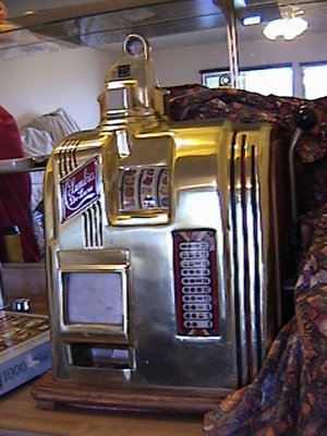

The best way to work on a Columbia is to have a working example for reference, I have four of the little gems and they work great, play and pay as intended including a DeLux which is set up for quarter play. Sorry about the quality but see the pic.
