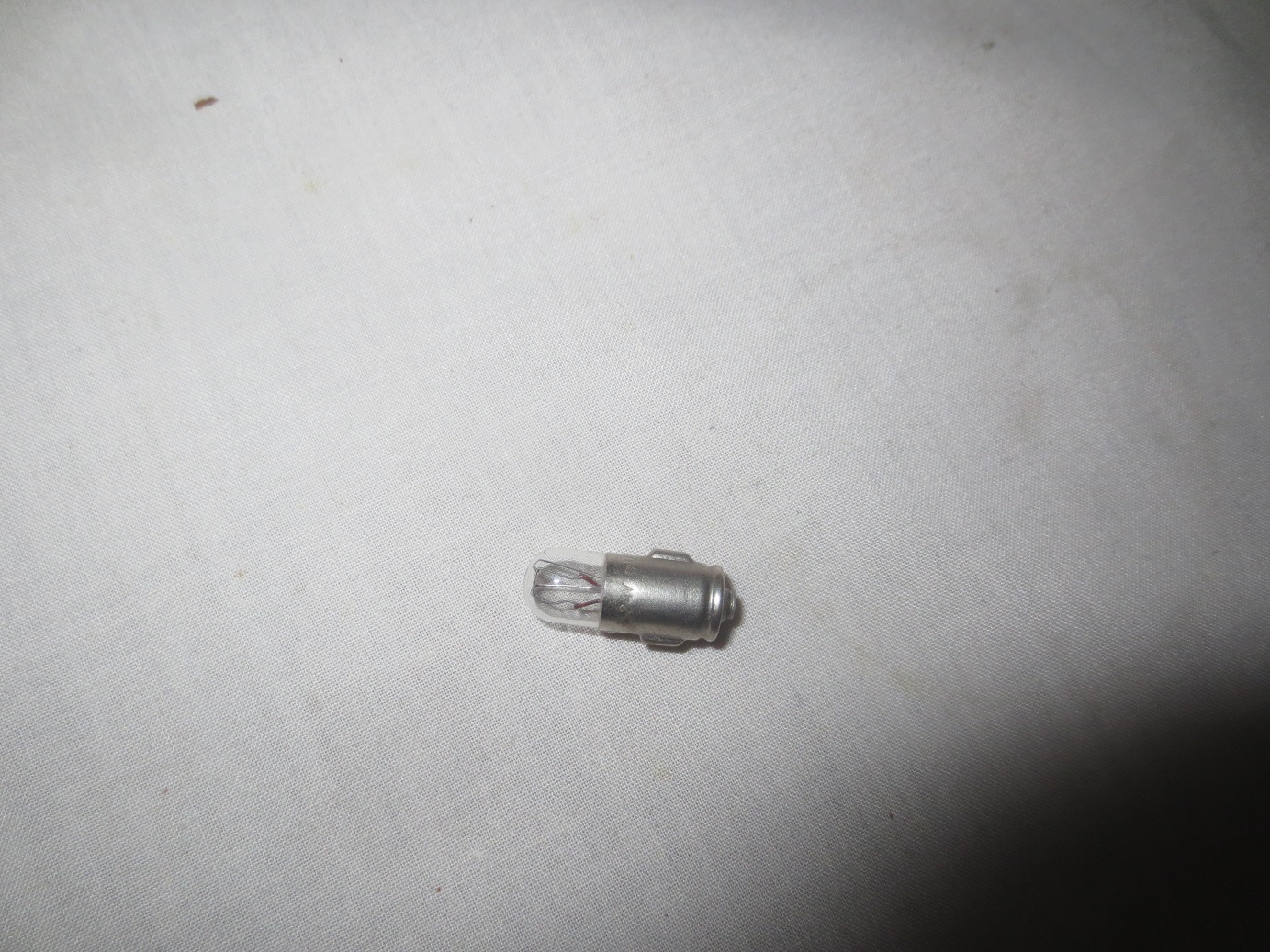

with the bulb the only writing on it is
24V 3W ALBA
cheers talk soon
With the globe here is a pic

Postby mechanic » Tue Jan 05, 2016 8:41 pm
Oliver looks like #4 is the problem child. I checked into the bulbs, they are a type of recreational vehicle bulbs. T2 - 24V - 3W BA7S Base. These are readily available here. If you cannot locate any let me know. They cost approx. $1.69 @. Check to be sure the wires on #4 are not touching some how. If they are seperate them, best is 180 degrees or opposite each other. Take another reading from the VOM if it does not read zero the short may be fixed. No further testing till you get new bulbs. There's a lot more to do if the bulbs don't get it going. A very tedious process of elimination !!! Also Congrats you have been very a very good apprentice. LOL !! TTYL Jim

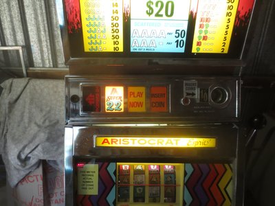

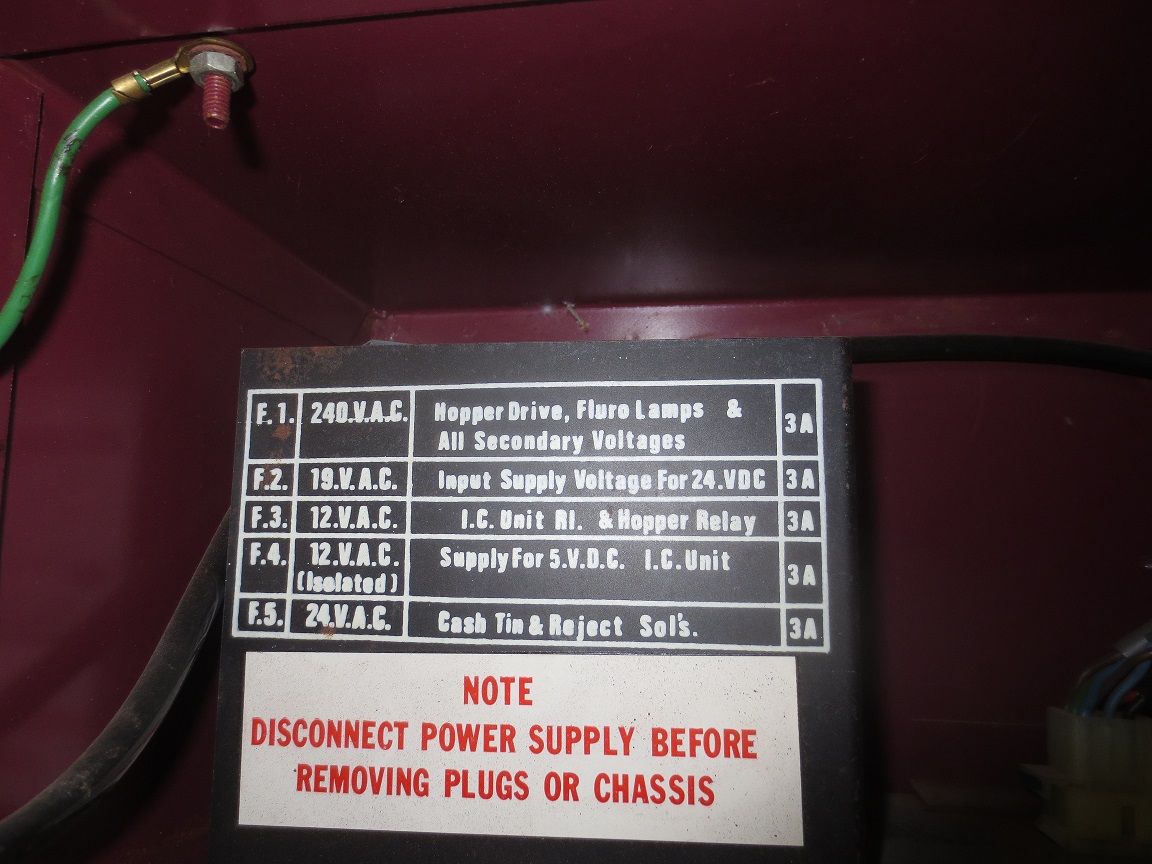

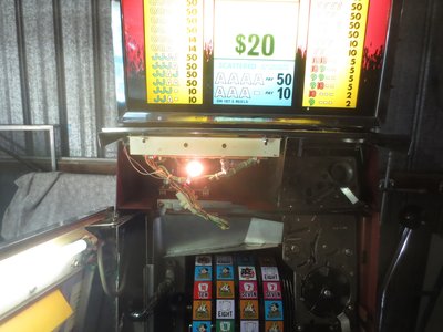

Now this is weird i thought i would take a pic of the fuse that was blowing and i am not sure as this is the fuse that controls those lights (but it is the one that blows all the time) see pic and maybee i gave you the wrong info before and this fuse has nothing to do with the lights i am not sure (the problem fuse is fuse 5 per the photo)
Now to make matters even more confusing, socket 2 lights up as per the photo but not the other sockets
and this is the best socket 2 lights up like the photo with fuse 5 removed not even there but not the other 3 sockets, so maybe we have been on the wrong track, i dont know. lol i am feeling rather dumb right now
Well i guess see what you think about it all, its kind of weird that socket 2 lights up but not the others and all sockets had bulbs in but socket 2 was the only one that lit up without a fuse, hmm no idea from me
Both the photo,s of socket 2 is with fuse 5 removed
