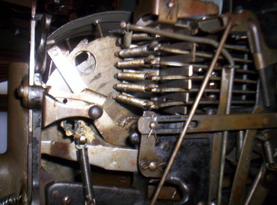

Picked it ip today and the payout scale is 19-21 ,15-17, 15-17, 11-13, 11-13, 7-9 ,7-9 ,4,4 and 2. Machine has a 17xxx serial number. I do have a question about the jackpot fill. It isnt working and I think I'm missing a spring. I took a picture and pointed to where I believe one end of the spring hooks but where does the other end go? All my Caille literature shows later (i believe) superiors and doesnt show this part.

Nobody can help on where the spring goes? I did find a picture on the net but cannot blow it up enough to clearly see. Is mine an early machine being serial number 17xxx?

Thanks Herb......you are right I believe.This machine appears to be a Naked Lady converted to a superior front with jackpot.Anybody else have one? Got the machine working again after welding the top slide. Only thing left to do is to get the right size spring for the jackpot lever fill and then the jackpot will fill after a payout.

Here is a picture of the kit.

Just joined today.... did you resolve the issue with the spring?

Yes..I got it working. I made a piece to go in there as well so that its basically fixed and moves in unison.
