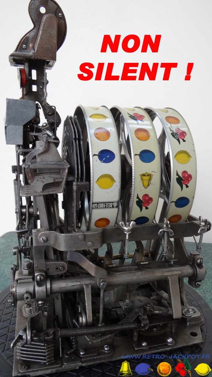

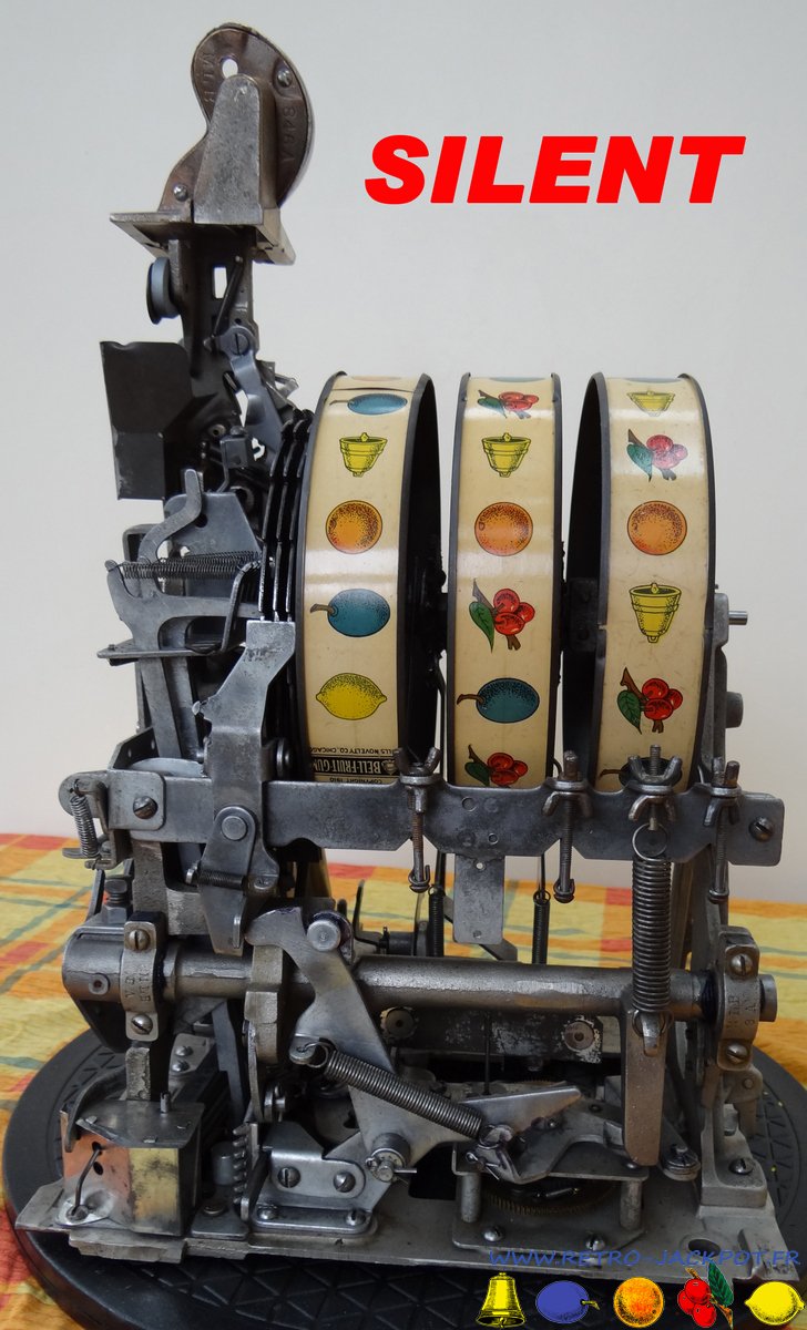

You are right !
Lion head, like skycraper are slots machine come from silent's serie. Silent serie was introduced in 1931. The mechanism in your Lion Head was made in the 20's... This is not a silent mechanism !!
Silent mechanism exist in 10 or 20 stops and in regulare or mystery paid (2-4 or 3-5).
Look photos :
Mills mechanism made in the 20's
Not silent mechanism
And
Mills mechanism in the 30'S - Goosneck Silent serie.
Mills Silent mechanism
