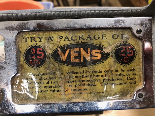

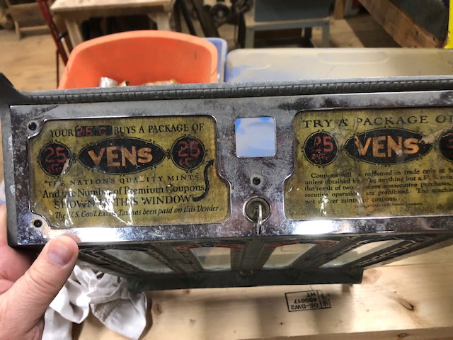

i have included here pictures of the award card from the 25 cent FOK i am currently restoring.

Okay, I took some more photos and uploaded them here: https://imgur.com/a/iwchkg7. Please have a look and keep the great info coming!
gsx11r: Thanks for the links! I just finished checking out the "gem". That's fantastic! I need to find an original copy. Will check out the other links soon.
Midcoast Vintage: Thanks for clarifying that 25 cents was a possible denomination. I hope maybe you'll be able to tell if the 25 cent on mine is original. Please check out the photo album linked above.

Midcoast Vintage , your award card is very Strange , If you remove it , do you can make a good scan ??? Do you can tell me if it s a patch for the "25ç and Quarter" or an original print ?? Please , give me more info about this , I m curious
