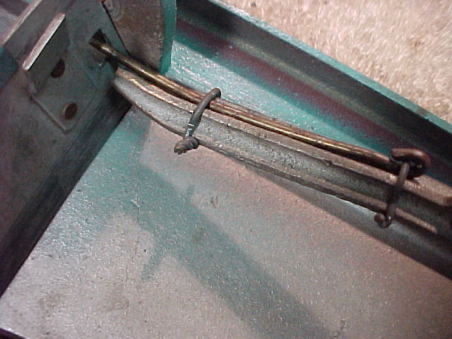

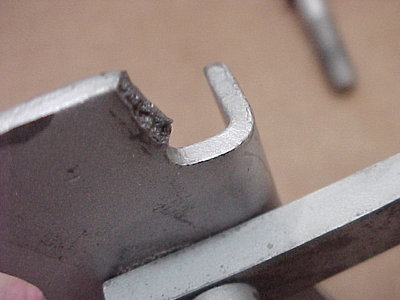

I am rebuilding a Callie Cadet 5 cent machine from about 1936...I have the mech set aside and I am working on the cabinet and the castings...I found 2 items that are broken and hope someone can supply a picture of each one and what it is suppose to look like...One item is the arm that controls the divider in the jackpot...It goes into the slide and dumps top jackpot when bottom one is hit. The arm was repaired with a piece of wire at one time...Was hoping someone can supply picture of it complete so I can do a better repair...Next is the "ratchet" on the pull handle...There is a piece of metal that appeared to be bent that broke off completely and never repaired...I hope the pictures show up as I may not know the correct names...Any help will be appreciated...

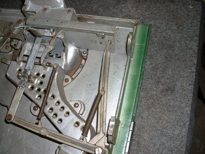

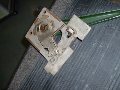

Postby marsonion » Tue Mar 26, 2019 6:45 pm

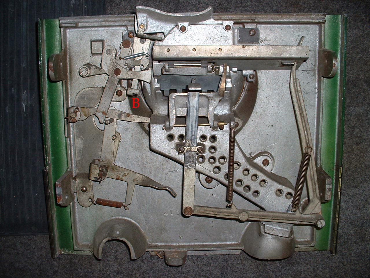

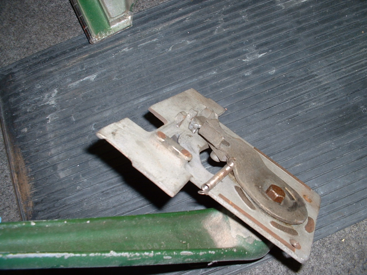

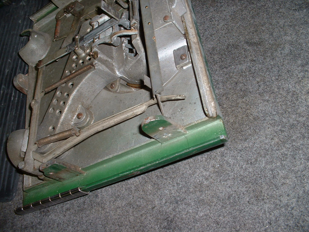

gvt1911 wrote:I am rebuilding a Callie Cadet 5 cent machine from about 1936...I have the mech set aside and I am working on the cabinet and the castings...I found 2 items that are broken and hope someone can supply a picture of each one and what it is suppose to look like...One item is the arm that controls the divider in the jackpot...It goes into the slide and dumps top jackpot when bottom one is hit. The arm was repaired with a piece of wire at one time...Was hoping someone can supply picture of it complete so I can do a better repair...Next is the "ratchet" on the pull handle...There is a piece of metal that appeared to be bent that broke off completely and never repaired...I hope the pictures show up as I may not know the correct names...Any help will be appreciated...
Hope these shots help...

Postby gvt1911 » Tue Mar 26, 2019 7:20 pm
Thank you for the great shots of the parts...I see that I am also missing another part on the jackpot...At least now I can repair what I have and go from there...Thank you again ! =D>

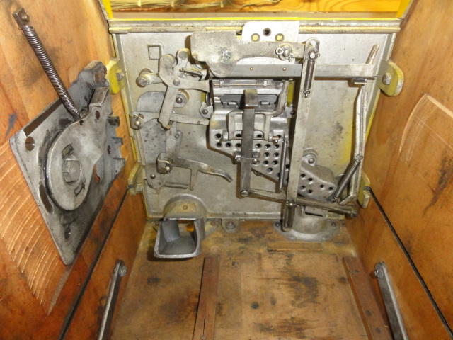

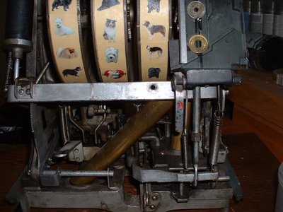

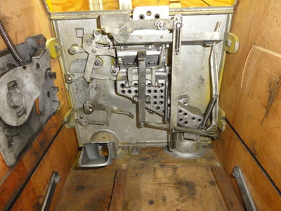

Postby flipper77 » Thu Mar 28, 2019 5:44 am
Here is an inside picture of an early Doughboy which is essentially the same as the Cadet - hope this helps.

Re: Caille Cadet Help
Postby flipper77 » Thu Mar 28, 2019 5:47 am
Last pic was low resolution. Here is a high resolution one.

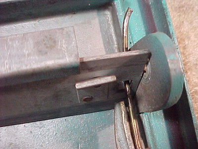

Postby marsonion » Thu Mar 28, 2019 12:26 pm
flipper77 wrote:Here is an inside picture of an early Doughboy which is essentially the same as the Cadet - hope this helps.
Flip

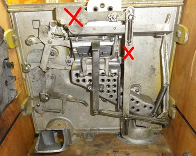

In fact, there are substantial differences between the Doughboy and Cadet hardware, particularly with regard to the JP/reserve feed machinery, and the devices which shut off the reserve feed when the reserve is full. Even parts which would appear to be interchangeable between these two models... aren't. The images below indicate the differences; instead of the "bouncing ramp" of the Doughboy, there is a "swinging ramp" (B) which, when coins pile up to overflowing in the reserve, swings across to block the "Knee" (A) hanging from the bottom of the escalator, which stops the feeding of the reserve on each 2-Cherry payout. (If you are a masochist with a morbid curiosity about how the equivalent Doughboy hardware works, search the terms "zig zag" and "bouncing ramp" on this forum.) This short video can help you understand some of the Cadet JP operations, too:
https://www.youtube.com/watch?v=gdwjI4mkF4U

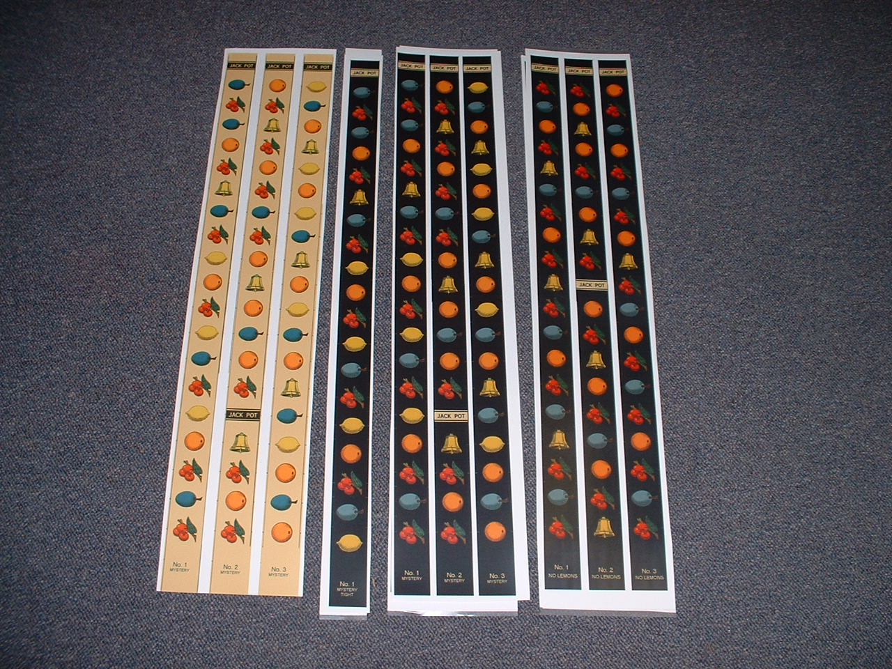

I am ongoing with this rebuild and would like to know if there is anyone with reproduction reel strips for this machine...??? The original strips are there, but heavily darkened with age... Any help would be appreciated ! :mrgreen:

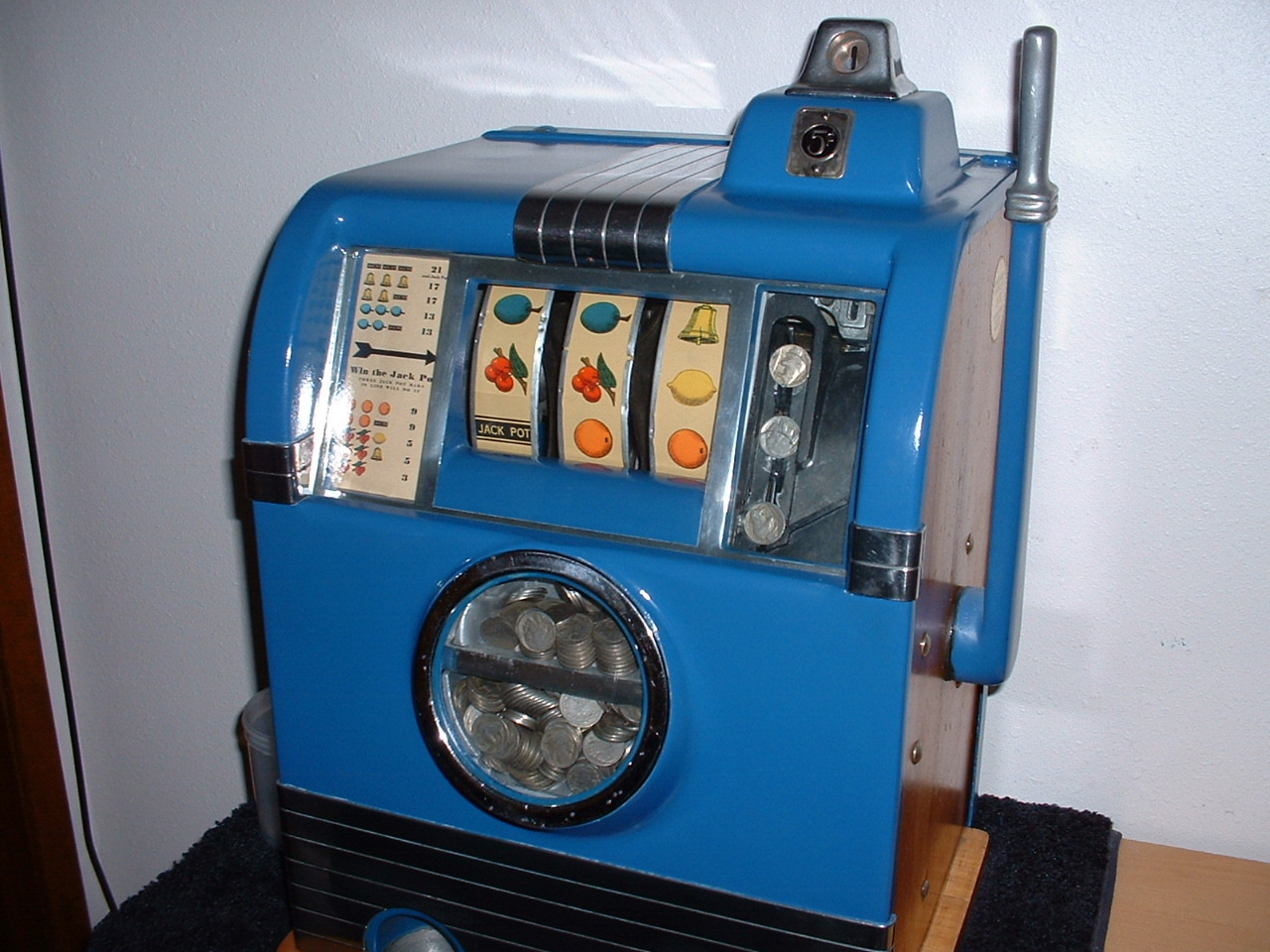

Postby marsonion » Wed Apr 24, 2019 4:11 pm
gvt1911 wrote:I am ongoing with this rebuild and would like to know if there is anyone with reproduction reel strips for this machine...??? The original strips are there, but heavily darkened with age... Any help would be appreciated ! :mrgreen:
Because the Caille repro strips available at the time were such garbage, I made some of my own. The picture shows what I have left of 20-stop Caille strips (I also have the Mystery "tight" first reel in buff, not pictured). These were produced using a high-end imagesetter on satin-laminated card stock. Check the symbol order carefully and PM me if interested. I also have 10-stops and Grand Prize repro strips available.
