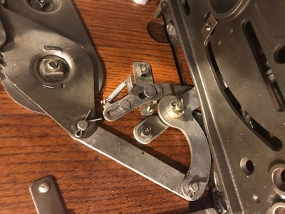

I am having trouble with the actuation of my side vendor from the mechanism on my Roman Head slot machine. Sal Mazzeo and I looked at the linkage on the inside of the housing and it was not being contacted by anything from the mechanism when actuated. I have a picture of both the mechanism and the housing of my machine. Can someone take two similar pictures. It sure seems like something is missing. Thank you. Scott

Two possibilities Take the spring off the trip arm on the inside and see if that clears it up which means the spring is too tight. The other is harder to do. You have to remove the top casting and watch how the trip dog hits the top of the trip arm. It could be a alignment problem between the two.
