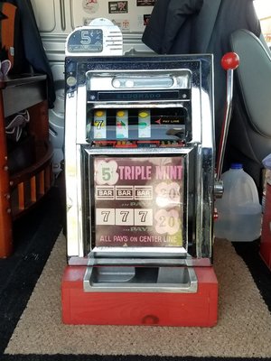

Postby breiaj » Tue May 07, 2019 2:20 pm
You have to put a nickel in to play and then it pays two nickels whether the spin is a win or not.
I’ll add pics and a video

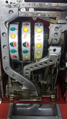

Postby MONTI » Tue May 07, 2019 2:35 pm
Looks like all the correct payout slides are present so you should be able to convert it back to standard payouts!
Spin that puppy so we can see the right side of the mech and get a good high rez picture of the vertical pay fingers and the horizontal slide release levers, Etc.

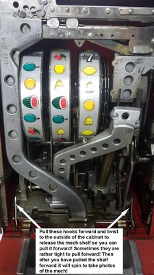

Postby MONTI » Tue May 07, 2019 2:48 pm
To get pictures of the mech follow the instructions on the photo here below!
This is easier than trying to pull the mech out by itself!

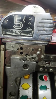

Postby rosekiller454356 » Tue May 07, 2019 4:28 pm
First of all you say it does not pay nickels.....then you say it pays 2 no matter if a win or not. Confusing for sure. One possibility is that the mech is a 2-5 pay. If so, it could be that the bottom (2 pay) horizontal payout finger is stuck to the left and will not return to engage the lower slide when reset occurs. You will need to cycle the mech out of the case to verify. If this is the case simply "wiggle" the finger back and forth to free it up from grease that has set for years. Hope this helps.
