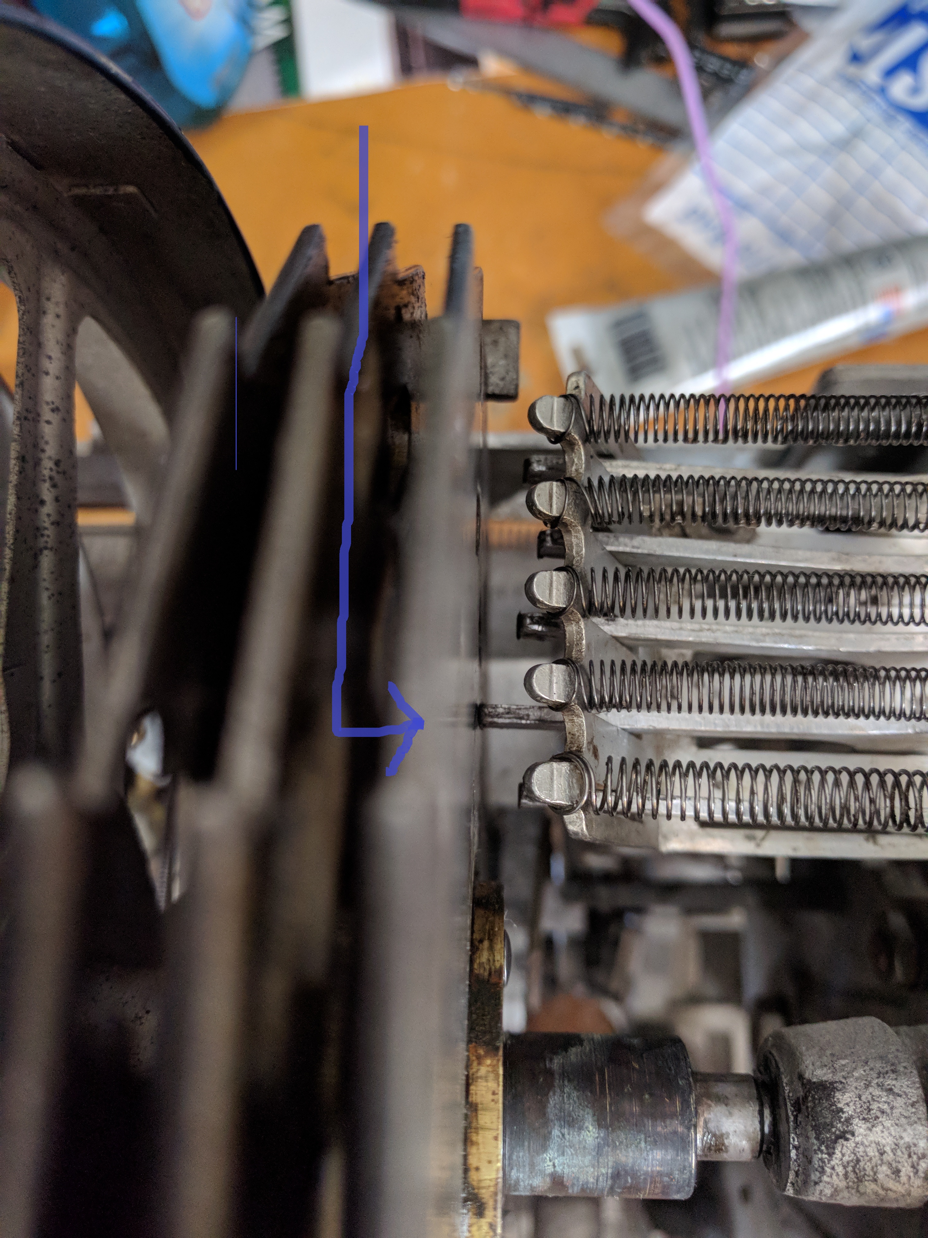

Hello,
I am stumped as to why I have one payout finger which does not get pulled back enough during the wind up cycle and then rubs against the 1st real payout disk. I did disassemble the Mech though I dont recall any problems prior to disassembly. I did not take out the fingers. I only removed the payout slides and real bundle in this area to clean, degrease, etc. so the payout finger assembly is still in tact.
Anyone have any ideas? See pics. Pics are of the mech wound up and almost ready to start the spin cycle.
Area showing 2nd finger from the front not being pulled back
Fingers up and payout disk

Two possibilities, 1. The finger had someone weld an extension to it since the rest look OK. 2. The finger is bent forward so it hits the plate. The top of the fingers should all line up here the springs attach. 3 Maybe they cut down the other fingers????? That would be just plain dumb.

mechanic wrote:Two possibilities, 1. The finger had someone weld an extension to it since the rest look OK. 2. The finger is bent forward so it hits the plate. The top of the fingers should all line up here the springs attach. 3 Maybe they cut down the other fingers????? That would be just plain dumb.
@Mechanic I dont know why I didn't see that!!! The finger is bent where it would contact the (not sure of the correct part name but is pictured in the 1st pic) contacts the finger, the finger is "U" shaped therefore will not be pushed back like the other fingers. Odd that it is bent. I dont see any damage anywhere that would indicate where something would have hit it since it would take a decent amount of force. It also is still straight side to side. None the less, I think you provided me a good route to look further into. Thank you!

Postby ThirdGenAmusement » Wed Jul 24, 2019 6:52 am
Ok, Mechanic nailed it. It is a bent finger. See pic.
