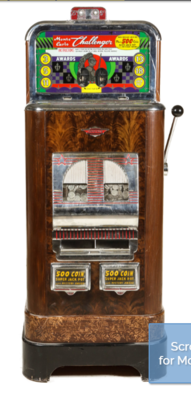

Custer, did you figure out your prospector in the end? I now have the Challenger monte carlo version and my red light flashes but never stays on. it is supposed to stay on every 4th pull, but doesn't. There is also a loose wire by the reed switches near the clock. can anyone advise?
