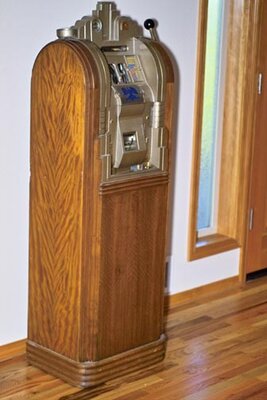

This machine I have offered to help fix. He says it spins and stops, but it won't accept coins or pay out.
Anyone know what that might be? I can get pictures of the mechanisms if you need any. Thanks
His exact words: " It is working and stopping as designed, but will not take coins or pay"...
He has owned it for over 60 years. Beautiful machine! (pics below)
