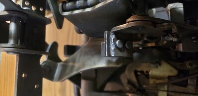

Postby TrinityB » Sat Jan 07, 2023 5:26 pm
Please see pic attached... do I need to replace?

Postby mazzeosa17 » Sat Jan 07, 2023 5:44 pm
If you mean you should replace that part because the kicker lever has three notches in it, no, not as long as the 3 reels are getting kicked off and spinning ok. At some point, the grooves may get too deep and you could have them build back up with a welding rod repair. But that's if the 3 reels are not getting kicked off properly and are not spinning ok.
