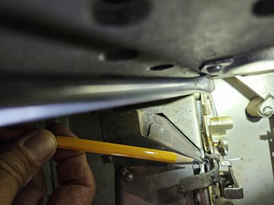

I was fixing a Mills 777 hitop for my father in law and found this spring disconnected. Does it connect to the arm just below it? Thanks.

Hello, This should help you on your jackpot spring locations

Got it. That does help. Thanks.
