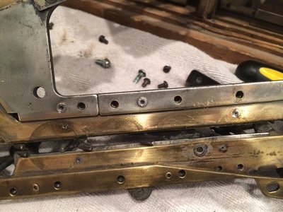

Does this look off to you guys I never had a 50c High top before and it looks like on of the teeth has maybe been cut off? The window only shoes 2 coins before the third drops. It looks like even if it had more teeth it would still drop the coin. Was this maybe a conversion?

Casinos and operators did this to help eliminate coins jamming in the escalator reducing service calls.thanks

Wouldn't the coin drop or start to drop even with a extra tooth? Also it is covered in caked on grease I'm going to stick it in de greaser is there anything on this part that needs re greasing if so what do you suggest using? Thanks

I think they called them rollaway escalators. I've seen them on quarter machine also.

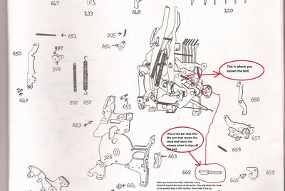

Here is the problem. The clock bar is not set far back enough so when you pull the handle the first reel hammer is coming down almost instantly I'm not sure how to fix this? I enclosed a YouTube video Showing whats going on. As for the grinding on the payout disc that was fixed with a few new softer springs. Thanks altort. http://www.youtube.com/watch?v=1Xj74v5x ... e=youtu.be

Sometimes this issue can be fixed by sliding the dog out just a little bit further. It will make the mech wind up just a little further before it slips off and the wheels fire. This has worked for me. If you need pics to show you where this is let me know. It is located at the rear of the mech on the busy side of the machine. It is the square metal rod about 1 1/2 inches long and held in place by a solid bolt.
Help pic for mills mech
